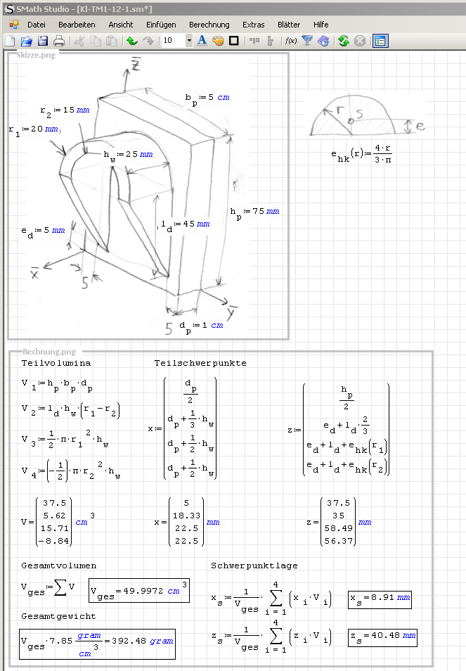

now that you are master of export and import, I would rise again the issue of automatic export regions. Initially I proposed to create a new region type ("export region" ) with properties described in the topic starter post. You proposed to save the sheet to images, perhaps splitted into page images. Image export of all regions is already possible by using html export via File> Save as.
How about just using the foldable region delimiters for export markup?
The idea is: whenever the plugin sees an area region with a file name as title (identified by supported name extensions) then it tries to export the contents of the area region to a file of that name and format. The images do not contain the region boundary and are trimmed to the size needed to show the included regions. Thus there is nothing to do in the target document except including a link to the file.
The target file is then automatically updated whenever you change the source document.

#4 Posted: 1/20/2013 2:57:34 PM
Hello w3bsurf3r,
One might argue what event should trigger that search and export. Options would be:
- any re-calculation of the sheet (which might slow down the GUI). Also, there might be the danger of ruining previously exported images e.g. if some plugin is broken.
- upon save operations
- upon explicit request (via special GUI element). I would see the danger to forget this before closing the sheet after changes.
I prefer the second option (execute export whenever and only when I save the file).
Could that be done with reasonable effort? It would be a significant simplification for handbook-writing or generating images for forum posts.
Martin
