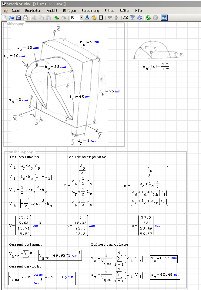

#3 Опубликовано: 19.01.2013 15:47:44
Hello w3bsurf3r,
now that you are master of export and import, I would rise again the issue of automatic export regions. Initially I proposed to create a new region type ("export region" ) with properties described in the topic starter post. You proposed to save the sheet to images, perhaps splitted into page images. Image export of all regions is already possible by using html export via File> Save as.
How about just using the foldable region delimiters for export markup?
The idea is: whenever the plugin sees an area region with a file name as title (identified by supported name extensions) then it tries to export the contents of the area region to a file of that name and format. The images do not contain the region boundary and are trimmed to the size needed to show the included regions. Thus there is nothing to do in the target document except including a link to the file.
The target file is then automatically updated whenever you change the source document.
One might argue what event should trigger that search and export. Options would be:
- any re-calculation of the sheet (which might slow down the GUI). Also, there might be the danger of ruining previously exported images e.g. if some plugin is broken.
- upon save operations
- upon explicit request (via special GUI element). I would see the danger to forget this before closing the sheet after changes.
I prefer the second option (execute export whenever and only when I save the file).
Could that be done with reasonable effort? It would be a significant simplification for handbook-writing or generating images for forum posts.
Martin

#5 Опубликовано: 22.03.2013 12:38:38
Here there is a modified ImageFileType plugin that save the screenshot of the entire worksheet (exactly like the built-in plugin) and a chunk of the screenshot for each page (when there are many pages). Actually I'm not able to retrieve informations from the area primitives, so separators are ignored.
NOTE: BACKUP YOUR BUILT-IN ImageFileType.dll BEFORE INSTALLING THIS PLUGIN.
regards,
w3b5urf3r
ImageFileType_source.7z (1,66 КиБ) скачан 789 раз(а).
Martin Kraska 23.03.2013 13:56:00
#6 Опубликовано: 23.03.2013 13:55:42
Hi Davide,
thank you for approaching the feature requested in this topic. I just tried the plugin by extending an existing sheet by a text region on the second page, immediately after the line break preview in smath.
The The separators are ignored as mentioned in your post. However, they affect the page break preview in smath and should be removed if control over what is printed to which image is required.
In order to be used for generating handbook images, the images would need to be limited to the page content's bounding box. I admit that this could perhaps be done by some batch clipping tool independently of your. In order not to produce sheets with 80% whitespace I could use smaller paper format settings. Unfortunately the item "user defined format" does not seem to work.
Image naming from within the sheet would be fine. Would it be feasible to trigger the image split by text or math regions, perhaps with the contents image="path/name.png"?
Martin
