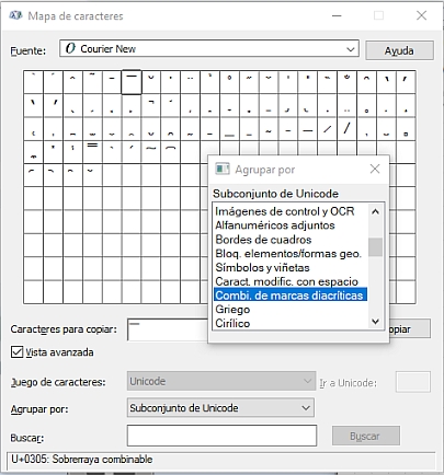

Hi. You can use unicode decorations. From the charmap app try to select them like in the image. There are not arrow but an overline and other useful like overdots.
For use in SMath copy from charmap and in SMath write a letter and paste the decoration for get things like this:

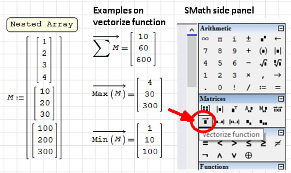

If you are referring to the vectorize function, please see attached image.
It is available in SMath side panel as shown.
