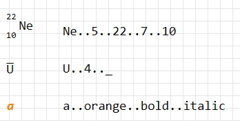

Hi. Since it seems to be a major improvement, which would require a good programming effort, it might be a good idea to think about the decorations in all possible positions, which are 8, surrounding the variable name. For subscripts you already have the notation ".", Inherited from Mathcad. Perhaps something like "a..1..x" can be used to represent the subscripts a.x (without abandoning a.x) and "a..2..x" up to "a..8..x" the other positions in the counterclockwise direction, being able to have one variable more than one decoration.
Finally, since it is a question of asking for improvements, for script, bold and change of the color of the variable, some other variation of the double point can be adopted to indicate those characteristics.
These would be some examples:
sergio 16.02.2021 16:21:00
