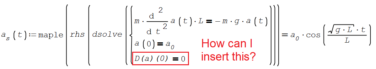

Derivative in Maple
Derivative in Maple - How insert - Messages
#1 Posted: 12/5/2023 12:53:18 PM
Valery Ochkov
Valery Ochkov
66 likes in 697 posts.
Pendulum.sm (233.97 KiB) downloaded 1393 time(s).
#2 Posted: 12/5/2023 1:38:18 PM
1,555 likes in 1,867 posts.
Ctrl+Shift+K.

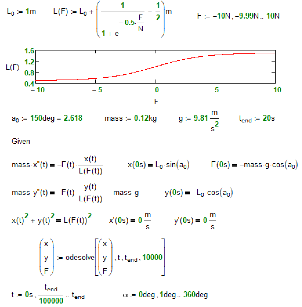

#3 Posted: 12/5/2023 10:44:09 PM
Valery Ochkov
Valery Ochkov
Ctrl+Shift+K.
Can we solve this task with SMath + Mathcad

Можно попробовать, если будет доступен оригинальный документ Mathcad.
#5 Posted: 12/6/2023 12:55:01 AM
Valery Ochkov
Valery Ochkov
Pendulum-Spring.xmcd (159.03 KiB) downloaded 1383 time(s).

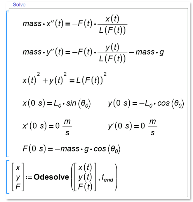

#6 Posted: 12/6/2023 3:09:08 AM
The definition of l(t) must be inside or above the Mathcad block
Federpendel-block.sm (39.22 KiB) downloaded 1388 time(s).

My solution
Pendulum-Spring.xmcd (82.56 KiB) downloaded 1402 time(s).

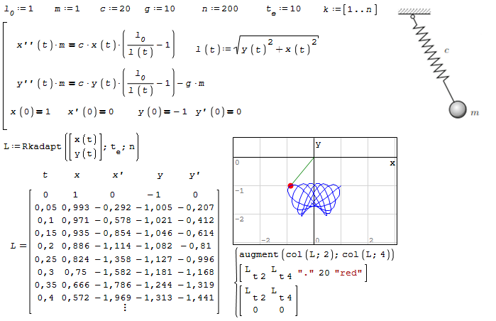

Animation needed
#9 Posted: 12/6/2023 7:57:07 AM

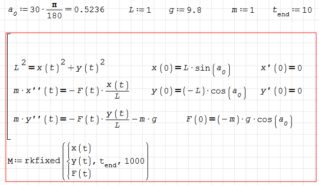

Simple pendulum + animation.
ODE Pendulum Copy.sm (103.31 KiB) downloaded 1385 time(s).

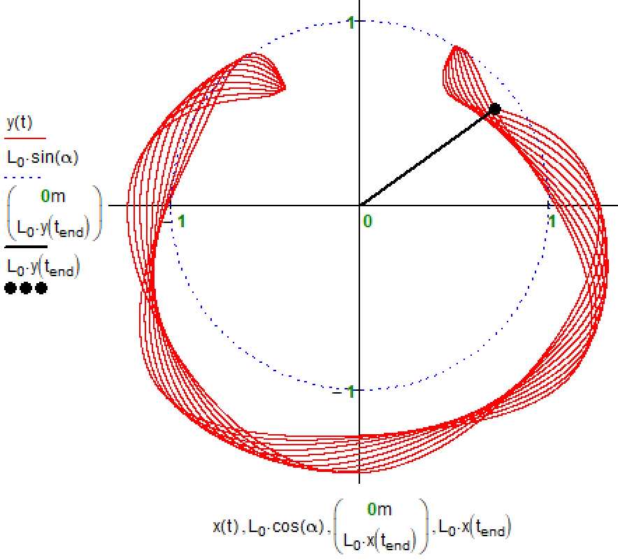

Comparing with the usual elastic pendulum.
Click to enlarge
Ochkov elastic pendulum.sm (32.17 KiB) downloaded 1352 time(s).

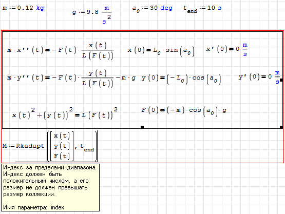

Why I have an error in this task? Help please!
Pund-Spring.sm (15.02 KiB) downloaded 1397 time(s).

#14 Posted: 12/7/2023 6:47:42 AM

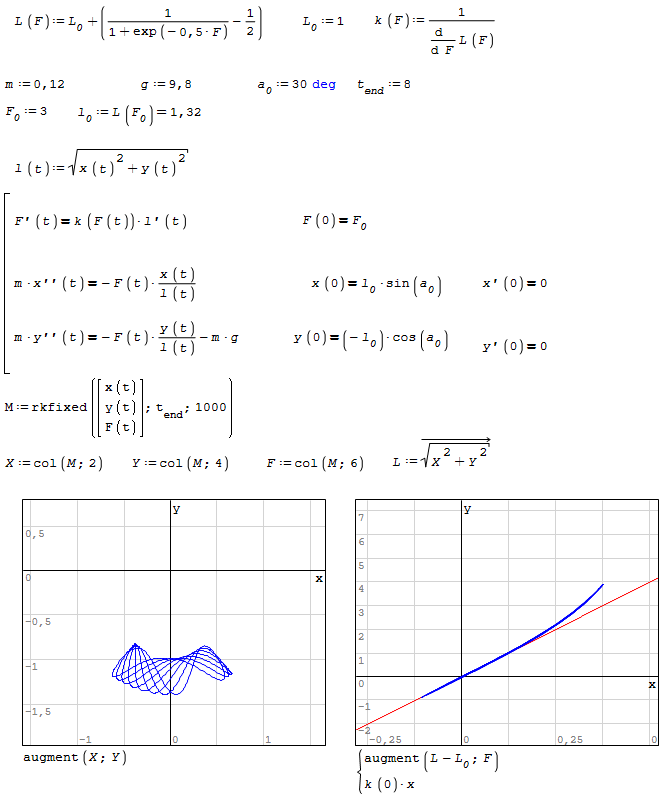

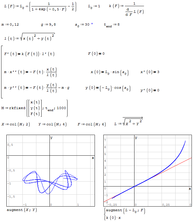

If F(t) is requested as result, you have to specify F'(t). k(F) is the tangential stiffness of the spring, the inverse of the tangential compliance.
Federpendel-NL.sm (13.71 KiB) downloaded 1389 time(s).

#16 Posted: 12/7/2023 3:59:36 PM
In this version you can specify the initial force in the spring. The initial conditions for x and y are adjusted appropriately.
Federpendel-NL.sm (15.06 KiB) downloaded 1406 time(s).

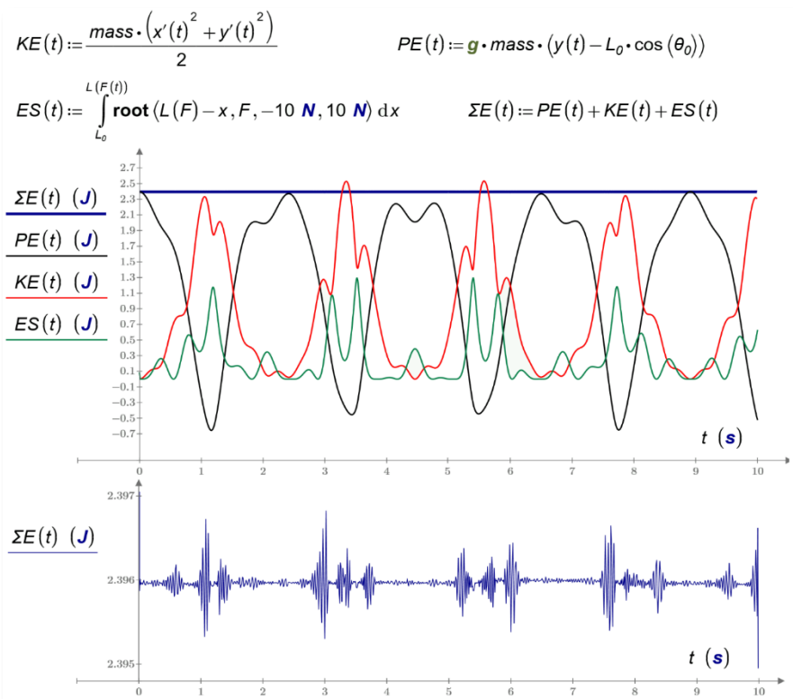

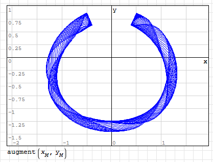

The equations of motion, using Lagrange dynamics, from this post:
ElasticPendulum.sm (244.53 KiB) downloaded 1385 time(s).
Valery Ochkov 12/8/2023 8:10:00 AM, sergio 12/8/2023 11:03:00 PM
#19 Posted: 12/8/2023 7:54:19 AM
In this version you can specify the initial force in the spring. The initial conditions for x and y are adjusted appropriately. ...
A comparison between Martin's solution and that given by the equations of motion obtained from the Lagrangian. Spoiler: both give the same result.
I'd like to point out how incredibly complicated this problem actually is, and what a series of brilliant implementations Martin makes. For example, where the hell does he get the time derivative of the force on an elastic bar when he is given only the length of the bar as a function of the force? Obviously, it is not enough to apply the theorem of the derivative of the inverse function, but you also have to have a deep knowledge of the mechanics of the system to remember something called tangential stiffness, and although it uses k to represent it, we forgive it because It's German and they are well known to use their own abbreviations. Well, actually I don't know what letter to use, because I don't remember ever using that magnitude for any practical purpose, but in Spanish literature it is quite common to use k for its inverse, which is the constant that appears in Hooke's law. Or at least I think so, because the existence of elastic bodies is actually a complication, they should all be rigid better.
Another notable thing about this example is that I would like someone to please explain to me how the hell the Viacheslav plugin manages to handle l'(t) within the equations, because I honestly didn't expect it.
Federpendel-NL - Lagrangian.sm (257.87 KiB) downloaded 1517 time(s).
3 users liked this post
Valery Ochkov 12/8/2023 8:10:00 AM, Martin Kraska 12/8/2023 3:04:00 PM, Вячеслав Мезенцев 12/8/2023 3:35:00 PM
#20 Posted: 12/8/2023 1:00:10 PM
Valery Ochkov
Valery Ochkov

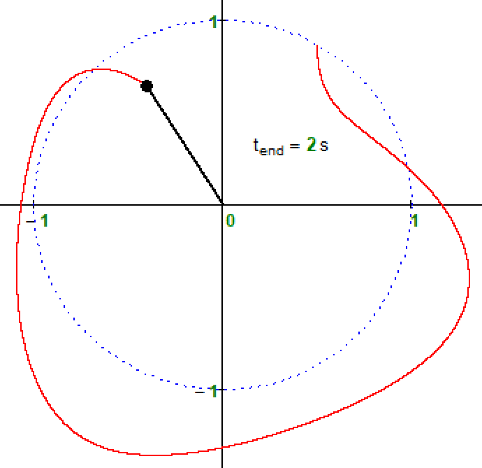

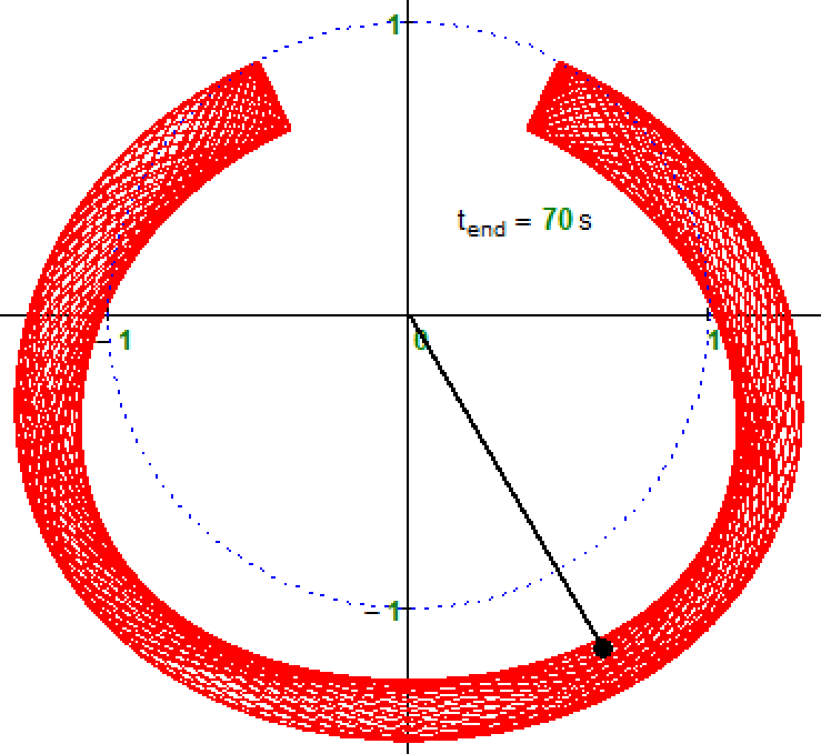

Have you seen this plot
