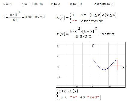

it's a rather simple thing but somehow I'm stuck. Consider a simply supported beam with concentrated force. Let's say that we don't know that deflection will be maximum with force acting in the middle of the beam. How can I find the maximum deflection in SMath ? Of course I have all the data and the formula for deflection of this beam:
But I assume that the distance a is not known and all values in the range of a=0 to a=L should be checked or maximum of the function should be found.
I've also attached the .sm file with data shown in the picture above.
Thanks in advance for you help.
Beam max deflection.sm (35.84 KiB) downloaded 1098 time(s).

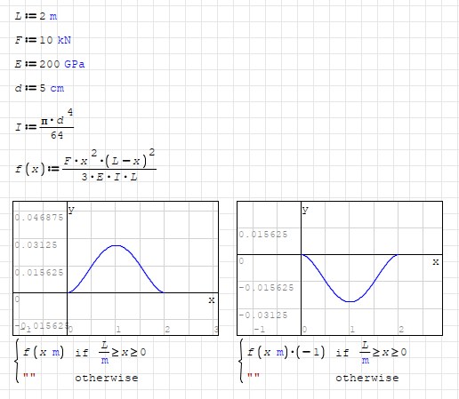

Hi. This?
Beam max deflection.sm (38.02 KiB) downloaded 1115 time(s).

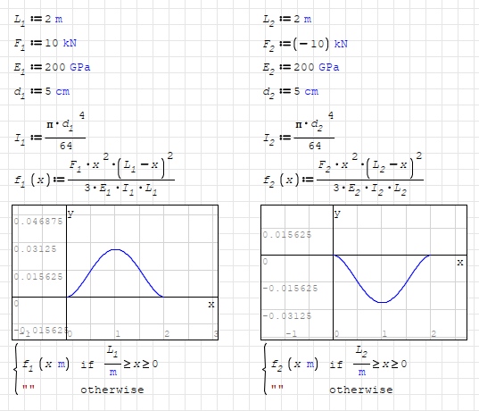

#3 Posted: 7/1/2021 2:42:00 PM
You don't say much about the project, let's invent something.
Beam max deflection [1].sm (48.61 KiB) downloaded 871 time(s).

Thank you very much. I just wonder why the plot has a concave part in the middle instead of being a regular parabola.

#5 Posted: 7/1/2021 3:49:15 PM
Parabola will be concave as well.
Parabola will suppose not anchored end points.
Make it as you wish.
#6 Posted: 7/1/2021 4:55:31 PM
598 likes in 1,379 posts.
Function has to to plot only between 0-L.
You have to limit otherwise it will try to plot for all numbers.
In case you don't limit, that will create the plot which Razonar provided.
Which is not wrong but over-plotted. No need to plot outside of 0-L.
You need to plot with units eliminated of course.
Since F is considered positive directioned, f(x) shall be plot as concave.
To plot as convex, try to reverse direction of F by multiplying it with -1.
Or simply reverse the f(x) by multiplying it with -1.
EngMath 7/1/2021 4:57:00 PM

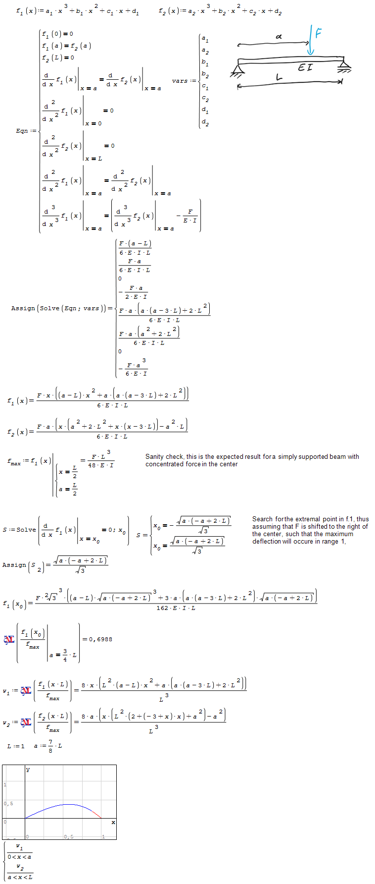

#7 Posted: 7/1/2021 5:04:12 PM
1,355 likes in 2,270 posts.
The formula given by the topic starter probably wasn't the elastic line but the dependency of the maximum deflection from the point of load application, i.e. a reference solution.
To find the same value with SMath you need to solve for the elastic line and then find the maximum.
If the formula was meant to be the elastic line, it would not meet the boundary condition (simply supported beam)

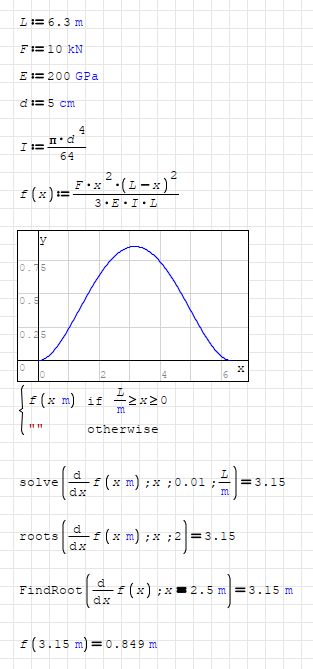

#8 Posted: 7/1/2021 5:15:23 PM
Let's say that we don't know that deflection will be maximum with force acting in the middle of the beam. How can I find the maximum deflection in SMath?
By the way, if we return to your original question;
Maximum or minimum peak point of a function is differentiate of that function.
You can find it with solvers like solve(), roots() or FindRoot().
First plot the function as it is, it will give you an idea for its maximum or minimum.
Just choose a fine starting guess for solvers, they will deal the rest.
Maximum deflection shall be the result of function by using the length which solvers found.
EngMath 7/1/2021 6:30:00 PM

#10 Posted: 7/1/2021 6:14:29 PM
Here is a solution for the elastic line of a simply supported beam from scratch.
I don't know what the formula in the topic opening post is meant to be.
Worksheet6.sm (47.27 KiB) downloaded 1060 time(s).

#12 Posted: 7/1/2021 7:42:54 PM
I was trying to use the root function as well but with no success. So the initial guess is necessary in this case ?
roots() and FindRoot() needs a starting point, a guess value to find the solution.
solve() doesn't need that "guess", it can find all solutions in the depicted range.
However, solve() shall need an assigned range if solution is not between {-20,20} or what range is chosen in options menu.

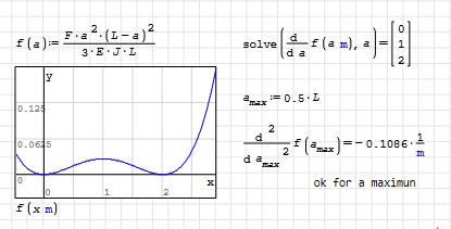

#13 Posted: 7/2/2021 8:56:04 AM
Thank you all for your replies. The formula attached to my first post is from a book (something like a Polish equivalent of Roark’s Formulas for Stress and Strain). It can be used to obtain the deflection at the point of force application.
Make that formula produce the graph as function of the point of applied force.
From there, the suite will come easily [Min/Max ...]. No Graph=NO suite.
As you can see, there is a missing link in your formula.
Beam max deflection.sm (52.93 KiB) downloaded 1104 time(s).
