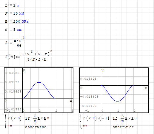

it's a rather simple thing but somehow I'm stuck. Consider a simply supported beam with concentrated force. Let's say that we don't know that deflection will be maximum with force acting in the middle of the beam. How can I find the maximum deflection in SMath ? Of course I have all the data and the formula for deflection of this beam:
But I assume that the distance a is not known and all values in the range of a=0 to a=L should be checked or maximum of the function should be found.
I've also attached the .sm file with data shown in the picture above.

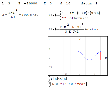

#2 Опубликовано: 01.07.2021 14:22:14
Hi. This?

Thank you very much. I just wonder why the plot has a concave part in the middle instead of being a regular parabola.
You don't say much about the project, let's invent something.
This project is nothing special. I'm just analyzing a simple case because I wonder how such thing can be done in SMath. Thank you for help.
#5 Опубликовано: 01.07.2021 15:49:15
Parabola will be concave as well.
Parabola will suppose not anchored end points.
Make it as you wish.
#6 Опубликовано: 01.07.2021 16:55:31
Function has to to plot only between 0-L.
You have to limit otherwise it will try to plot for all numbers.
In case you don't limit, that will create the plot which Razonar provided.
Which is not wrong but over-plotted. No need to plot outside of 0-L.
You need to plot with units eliminated of course.
Since F is considered positive directioned, f(x) shall be plot as concave.
To plot as convex, try to reverse direction of F by multiplying it with -1.
Or simply reverse the f(x) by multiplying it with -1.
