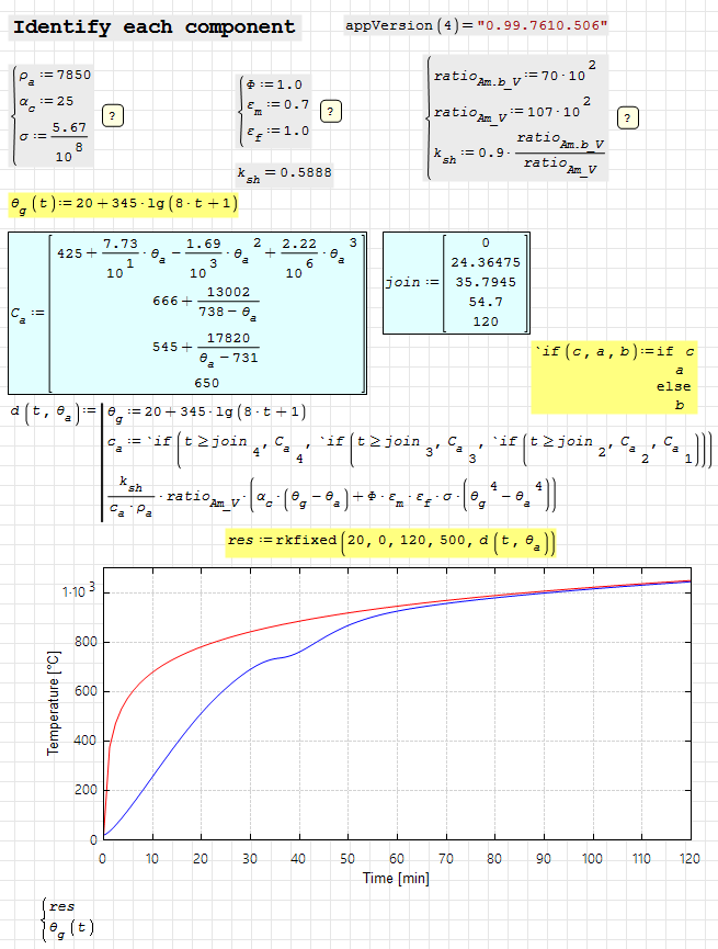

Do you mean something like "Steelfire" done/augmented a while ago ?
ODE Multiconditional [Steel fire].sm (63.85 KiB) downloaded 794 time(s).
Like this..
One of my memory cards decided to leave me hanging this weekend.. I guess I've spent too much time on SMath.
Cheers.
Steel_temperature_complete.sm (90.65 KiB) downloaded 1021 time(s).

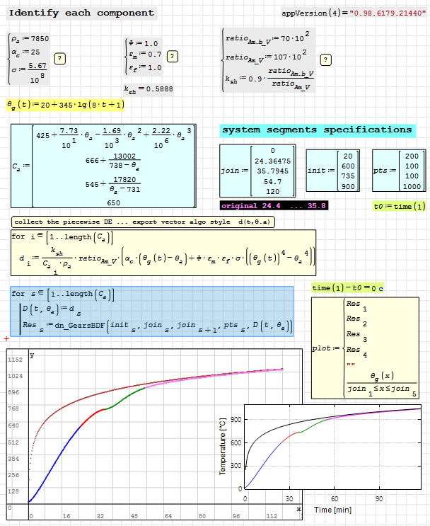

The document is indeed red top to bottom.
Anyway, although the document became less "techincal" after uniting all pieces in one single ODE using cases(), the project is now complete after some testing against a Excel spreadsheet I found online.
SMath community comes through once again!

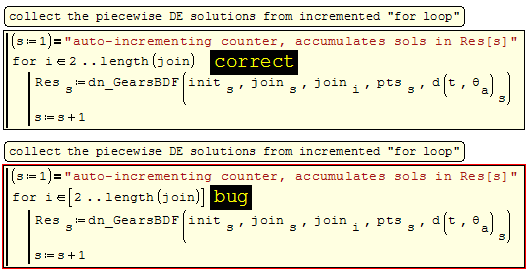

Was that bug introduced at time indexing the LHS definition 'data[i:= ...'
At work Doctors

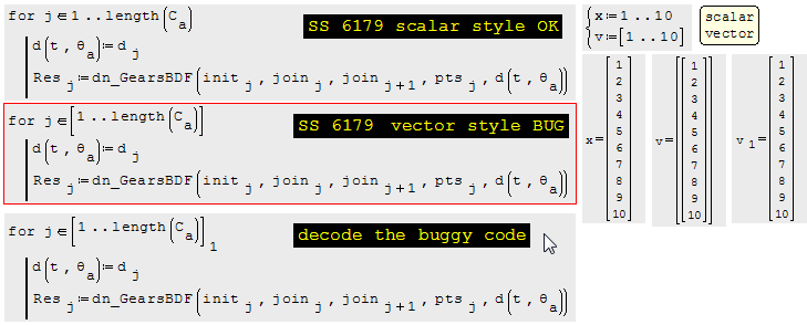

The switch from 5346 to 6179 didn't destroy any of the previous 5346.
That latest SS destroys 6179 is purely a bug.
Mathcad 11 didn't destroy previous Mathcad 8
Decode the freaked code is non-sense to me.
Hello Hanski, try to decode the bug, let's see if it goes to end.

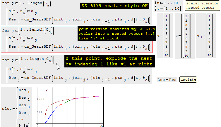

#116 Posted: 11/13/2020 2:55:37 PM
Jean,
My very limited capabilities within SMath is unable to «doctor» this.
I understand SMath is a work in progress (thank god). It seems a shame older sheets are throwing up errors because the structure/use of functions are no longer supported/have changed.
1. That piece that turned red in your *.PDF, try to code as per Uni snippet.
2. Otherwise, try to doctor the damaged SS 6179 as demonstrated.
There is no justification for your SS version to convert SS 6179 scalar into nested vector.
That to me is a bug that may render zillions documents red from the Samples Repository.
Please report where you stand-in [blue sky, red document, OK].
Cheers ... Jean.
ODE Multiconditional [Carlos Compactum] Copy.sm (82.73 KiB) downloaded 827 time(s).

Yes, not happy latest SS converts SS 6179 scalar into vector.
Thanks for your immense contribution ... Jean.

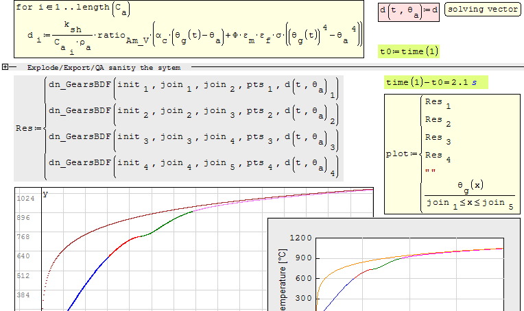

#119 Posted: 11/14/2020 11:05:50 AM
... w/o for loop, still conserving the export for QA sanity.
