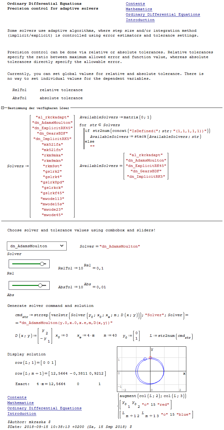

There might be smoother ways but this works. Note that I had to replace the sliders because the old regions don't seem to work any more with new SMath versions.
Section Math ODE precision.sm (23.08 KiB) downloaded 1016 time(s).

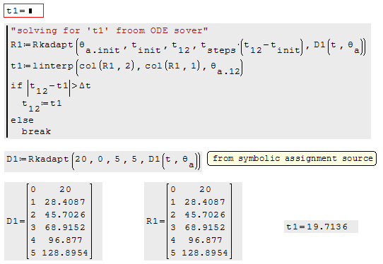

but when I wrap the ODE into a for loop (a necessity to establish boundary conditions for the whole set of ODEs) something goes wrong..
1. The for loop not needed
2. something goes wrong argument must be scalar
't' is not a free running scalar in your for loop.

Turns out the ODE solvers cant handle if() in the D argument, which led me down the path of creating a system of ODEs.
I just found out the ODE solvers can deal with cases(), which means there is no reason to separate the ODEs in the first place.
No need for for loop or solve function to find where one ODE ends and another start anymore....
