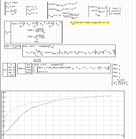

Does that mean that you think the last approach i did is the best way to solve the problem? The trick i think is to establish boundry conditions for ODE2,3,4 which is done by iteration till t.xy in the input box matches t.xy in the calculation after all the constants is established
Radovan is right: the functional relationship is in term of finite differences,
i.e: for pre-computer age. In fact you just need to integrate the RHS member.
You could think of the integrator operator, that would be a great mistake
on two counts: the operator is horribly slow and may be unusable wrt accuracy.
The "RK" integrator is hyperfast [probably from borrowed code] and accurate.
The other question is if RK supports conditional ... answer is YES
The attached confirms, unfortunately a single conditional.
I don't understand the conditional of your project.
@ 735 °C, steel is pink, visible in the dark, soft, not black smith works.
@ 900 °C, red hot for forging. Why is the conditional infinity @ 735 ?
Just observation(S) ...

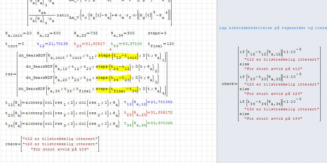

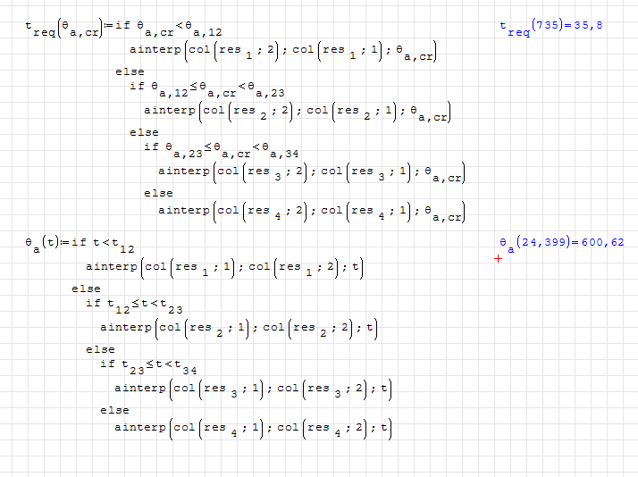

... finally, your project is completely correct as it looks.
Observe few modifications to get equally spaced data result,
1. re-arranged the number of points
2. submatrix to get rid of duplicates
3. spline "global"
4. discretise 1,2,3 ... or at will as you wish.
Saved in my personal file, thanks ... Jean
ODE Multiconditional [Steel fire].sm (37.31 KiB) downloaded 897 time(s).

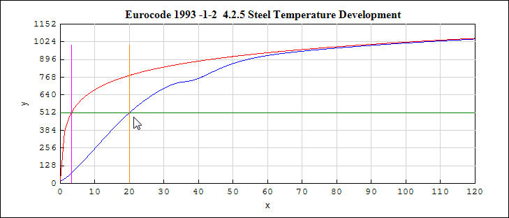

#46 Posted: 10/30/2017 2:15:47 PM
... two pages of Engineer's stuff has been added [page: 3, 4]
The two solvers are fully automated, i.e: given Y on the red curve
they both solve for their respective values on the X axis.

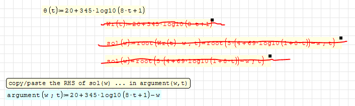

The function 'θ(t)' does not have an explicit "inverse". No problem
for solving with the Smath solve bloc. We can solve both iteratively,
not offered ... just ask for ... will be pleased to provide.
Conserve preciously the "root" technique ... sometimes more involved.
This project could not have been done so neatly Mathcad 11.
Title, X, Y axes need some identifier(s).
ODE Multiconditional [Steel fire].sm (53.94 KiB) downloaded 866 time(s).

Interessting How do you "calibrate" the T-matrix when the input changes?
It's great to see all the attention this project has gotten, seeing as it is a highly relevant problem for engineers.
#50 Posted: 10/30/2017 8:00:42 PM
If you change the input (ratio.Am_V and ratio.Am.b_V is the ones you will likely change), the DE's gets disconnected.
You are right there ! The system is not homogeneous, it depends upon
those parameters you mention ... like a monkey business. You must recast
the system like you did wrt critical temperature ... Oh ! that's your
competence. That stuff is Chinese to me.
BTW: attached the discrete solvers. All in all a huge/interesting project.
Cheers, Jean
ODE Multiconditional [Steel fire].sm (63.3 KiB) downloaded 883 time(s).

I haven't had much time to progress on this project during the weekend. I will work more on it this week (for instance stack all the solutions and submatrix the junctions like you showed us )
Is this what your were looking for regarding automating equal steps?
Best regards,
Hans Kristian
Edit: Upon closer inspection, computational times using your method of stacking all the DE's increases dramcatically. To calculate temperature at a given time takes ~1,3sec using your method.
Using my method (granted much more primitive, and it does give some unatural results in the crossover between the DE's, the computational times are ~0.15sec.

You have several points in one remark:
1. The compactum method is not shorter in work sheet space. It is slower
because of the counter cumulative in "for loop" ... just interesting.
2. Your "steps*(,-,) computes more points 603 vs mine 491
thus slower up to the result. No interest as it produces the duplicates.
3. unatural results in the crossover between the DE's
You have put the finger in the wound !!!
There are very many more "splines" than Smath "ainterp [Akima], cinterp"
Of all the splines [lot] I'm familiar, NONE will accept duplicate
points ... worse: in this work, the duplicates are zombies , Ah !
So, you must strip for duplicates [submatrix does it well]. By same token,
once striped and stacked, the piecewise "ainterp" is completely useless.
As a remark, Smath "ainterp, cinterp" are hyperfast ... they spit 1000 data points
before it seems to have digested .
"cinterp" looks 1/1 universal vs others [Mathcad ...]
"Akima ainterp", I have not seen under the hood of it. From using, it reveals
very excellent in some works, but also pure scrap in other type applications.
4. After stripping, the f(x):=ainterp(X,Y,x) is passed in the reconstruct
discretiser to re-tabulate for equal points spacing as an export. For
interpolation, just spline over this data table.

Both methods start plotting @ 20 °C as specified from "if/otherwise".
2. Often, "maple/solve" returns the inverse function.
This one though it looks simple does not, alternately "root" does.
and by same token result is the simplified expansion.
This refreshed version looks like nearly the "last brick in the wall".

#58 Posted: 11/2/2017 6:42:52 AM
This project has been re-organised a bit for publishing.
Few things are missing: an abstract, identify the X,Y plot arguments.
The discrete solver/collector can be set incremental for finer tabulation.
ODE Multiconditional [Steel fire] Copy.sm (67.69 KiB) downloaded 950 time(s).

I have organized my worksheet somewhat now, and collected only the relevant parts for my specific problem at the top. The other stuff that although it displays the power of SMath - it's not relevant for this workbook, is gathered at the bottom.
I really appreciate all the help you have given med Jean!
Something mysterious, it does not download *.sm, only some sort of "Chrome" document.
Nothing to see, that's OK unless I can help more.
Cheers, Jean
