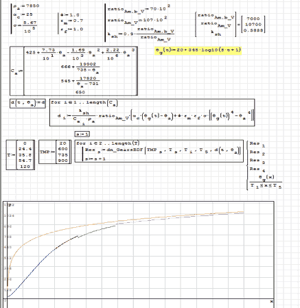

#45 Опубликовано: 30.10.2017 11:23:34
... finally, your project is completely correct as it looks.
Observe few modifications to get equally spaced data result,
1. re-arranged the number of points
2. submatrix to get rid of duplicates
3. spline "global"
4. discretise 1,2,3 ... or at will as you wish.
Saved in my personal file, thanks ... Jean
ODE Multiconditional [Steel fire].sm (37,31 КиБ) скачан 897 раз(а).
sergio 30.10.2017 11:47:00

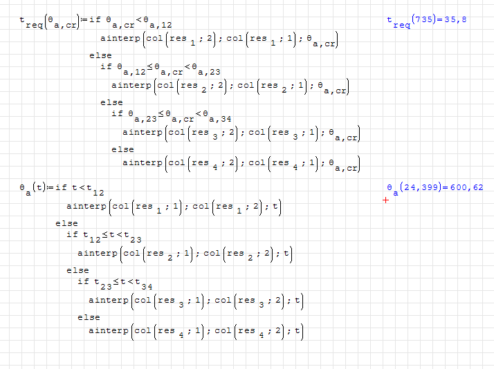

#46 Опубликовано: 30.10.2017 14:15:47
... two pages of Engineer's stuff has been added [page: 3, 4]
The two solvers are fully automated, i.e: given Y on the red curve
they both solve for their respective values on the X axis.
The function 'θ(t)' does not have an explicit "inverse". No problem
for solving with the Smath solve bloc. We can solve both iteratively,
not offered ... just ask for ... will be pleased to provide.
Conserve preciously the "root" technique ... sometimes more involved.
This project could not have been done so neatly Mathcad 11.
Title, X, Y axes need some identifier(s).
ODE Multiconditional [Steel fire].sm (53,94 КиБ) скачан 866 раз(а).
sergio 30.10.2017 14:44:00

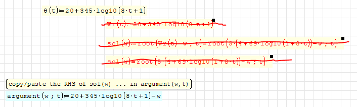

#57 Опубликовано: 01.11.2017 07:47:09
Cool stuff. The "discrete solver/inverser" takes approx 12 seconds to solve on my computer. None of the graphs start out at 20degC though, why is that?
Edit: Stupid question; what is the purpose of the "root" expression in your workbook? Couldn't the original theta.g expression be used in the solver instead?
1. Copy/paste the last collapsed area in new sheet.
Both methods start plotting @ 20 °C as specified from "if/otherwise".
2. Often, "maple/solve" returns the inverse function.
This one though it looks simple does not, alternately "root" does.
and by same token result is the simplified expansion.
This refreshed version looks like nearly the "last brick in the wall".
Please: don't hesitate for more questions ... Jean
ODE Multiconditional [Steel fire].sm (64,14 КиБ) скачан 887 раз(а).

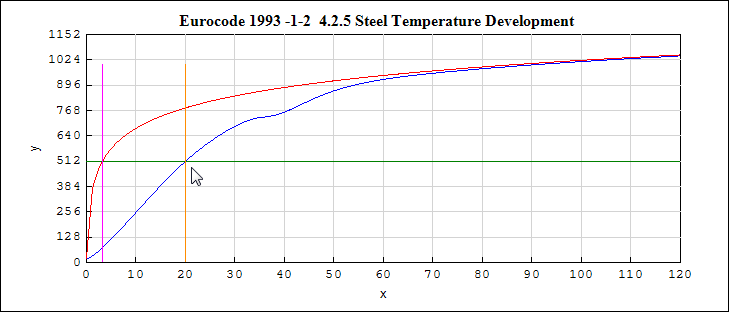

#58 Опубликовано: 02.11.2017 06:42:52
This project has been re-organised a bit for publishing.
Few things are missing: an abstract, identify the X,Y plot arguments.
The discrete solver/collector can be set incremental for finer tabulation.
ODE Multiconditional [Steel fire] Copy.sm (67,69 КиБ) скачан 950 раз(а).

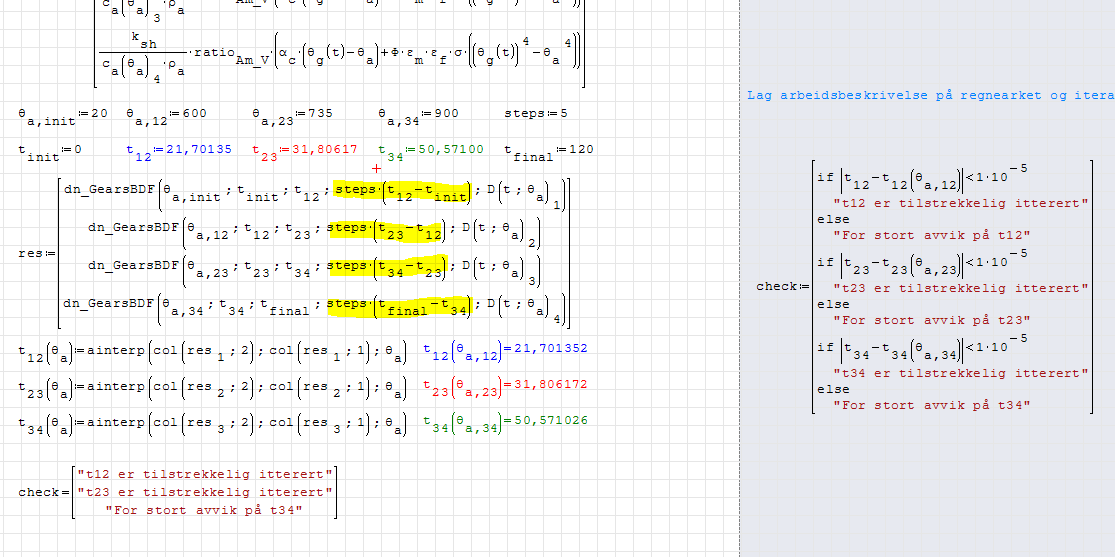

#59 Опубликовано: 02.11.2017 17:41:43
hanskl
hanskl
7 сообщений из 158 понравились пользователям.
I have organized my worksheet somewhat now, and collected only the relevant parts for my specific problem at the top. The other stuff that although it displays the power of SMath - it's not relevant for this workbook, is gathered at the bottom.
I really appreciate all the help you have given med Jean!
