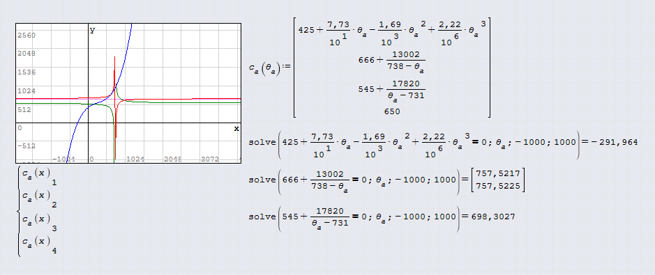

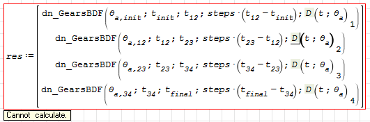

Jean,
I must be missing something.. I tried to downgrade to suite 6671, and dn_GearsBDF still tells me it cannot calculate.
I don't understand why the DE cant handle e^ø. Or have I constructed the DE wrong?

Jean,
The books style are very difficult to put it executable.
Your DE setup looks quite correct: proof the first one works
but the 2, 3, 4 "Division by 0". It must have to do with the
meshing of the Solver. It does not like something in there.
Should work in your latest 6671.
I simply reconstructed piece wise, simplified, on my 6179.
See U tonight ... Jean

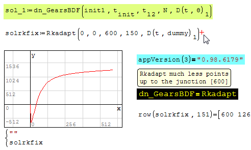

Hanski,
A bit of headache
Those solver may fails ... guess the cause "Division by zero".
You should have the first segment running as the picture.
Just to show how difficult it could be, read the ODE Yuk.

A bit of headache

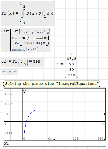

#77 Опубликовано: 08.05.2018 22:44:00
Is Mathcad able to handle this DE? Can anyone try to solve it there?
I doubt because rkfixed, Rkadapt are same.
The first segment maybe ? from the "Stiff option"
Good news is that the project has an elegant solution.
It consists in solving the Integral Equation
Will post it before bed time ...
#78 Опубликовано: 09.05.2018 00:03:51
... maybe there is some applicable scaling factor ? ?
Temperaturforlop Compactum Copy.sm (48,23 КиБ) скачан 1093 раз(а).

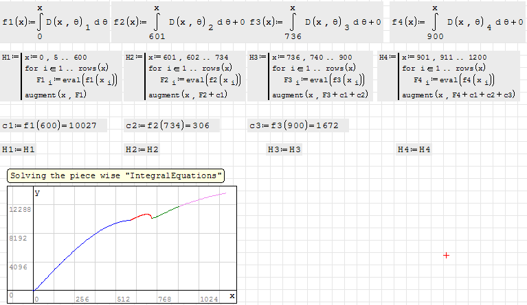

#80 Опубликовано: 09.05.2018 10:55:01
But from the top of my head - the X-axis should represent time in minutes, not temperature.
Also, it took quite some time for the sheet to finish calculating.
Best regards,
Hans Kristian
1. You can leave it in native 't'
2. the default Integration accuracy is 100, set it 50
it will have no influence in this application but much faster.
1.7 min in my 1.66 GHz laptop runs 225 greedy maths.
3. Does your version bracket t:=[0,5..600] ?
rather than Smath 6179 t:=0,5..600
Temperaturforlop Compactum Copy.sm (53,22 КиБ) скачан 1075 раз(а).
