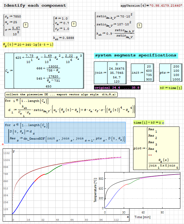

Do you mean something like "Steelfire" done/augmented a while ago ?
Like this..
One of my memory cards decided to leave me hanging this weekend.. I guess I've spent too much time on SMath.
Cheers.
Steel_temperature_complete.sm (90,65 КиБ) скачан 1130 раз(а).

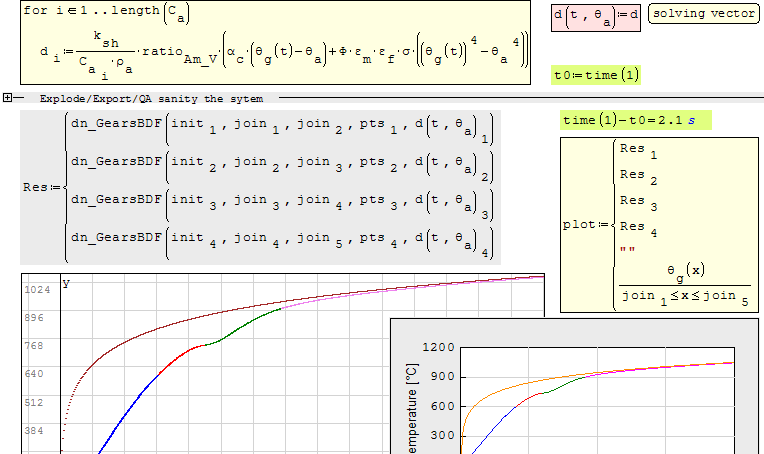

If you join visibly, no need for the TOL.
In short wrt your SS version, you must arrive at the exportable pieces.
Each piece for QA sanity check [Matlab, Mathcad ...]
ODE Multiconditional [Carlos Compactum] Copy.sm (80,79 КиБ) скачан 993 раз(а).

Anyway, although the document became less "techincal" after uniting all pieces in one single ODE using cases(), the project is now complete after some testing against a Excel spreadsheet I found online.
SMath community comes through once again!

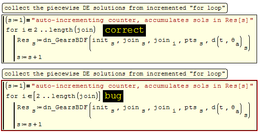

Of so many utilities that make Smath productive, the auto-increment for loop
is by large the most used and necessary. If I would update my 6179,
a great percentage of my 2500 documents would turn red hot.
Hope designers read this. If not acknowledged, will report in "Bugs"

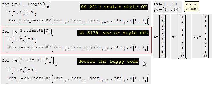

Was that bug introduced at time indexing the LHS definition 'data[i:= ...'
At work Doctors

Hello Hanski, try to decode the bug, let's see if it goes to end.

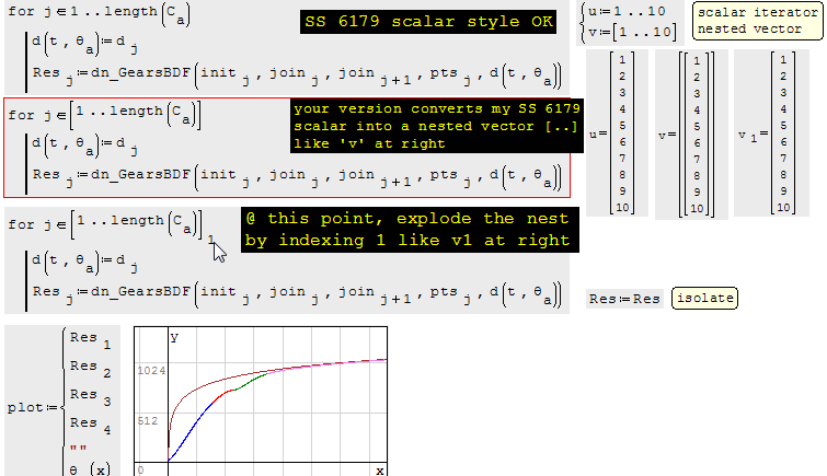

1. That piece that turned red in your *.PDF, try to code as per Uni snippet.
2. Otherwise, try to doctor the damaged SS 6179 as demonstrated.
There is no justification for your SS version to convert SS 6179 scalar into nested vector.
That to me is a bug that may render zillions documents red from the Samples Repository.
Please report where you stand-in [blue sky, red document, OK].
Cheers ... Jean.
ODE Multiconditional [Carlos Compactum] Copy.sm (82,73 КиБ) скачан 945 раз(а).

Yes, not happy latest SS converts SS 6179 scalar into vector.
Thanks for your immense contribution ... Jean.

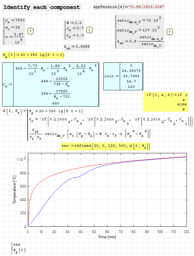

#119 Опубликовано: 14.11.2020 11:05:50
... w/o for loop, still conserving the export for QA sanity.
