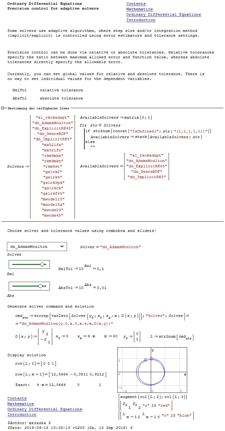

There might be smoother ways but this works. Note that I had to replace the sliders because the old regions don't seem to work any more with new SMath versions.
Section Math ODE precision.sm (23,08 КиБ) скачан 1016 раз(а).
#90 Опубликовано: 01.11.2020 05:44:28

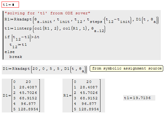

It works fine when I apply it to ODE itself, but when I wrap the ODE into a for loop (a necessity to establish boundary conditions for the whole set of ODEs) something goes wrong..
Cheers
1. The for loop not needed
2. something goes wrong argument must be scalar
't' is not a free running scalar in your for loop.
