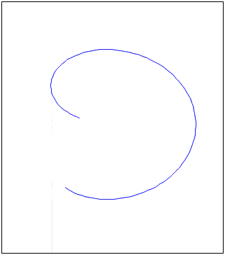

This method was suggested by the author of the "Method of Draghilev" prof. Alexei Ivanov.
1.st through the matrix of three columns (x, y, z) to construct
3d graph and select the desired Rakurs;
2.Using linear coordinate transformations turn
all points of the matrix at an angle (angles) corresponding
Rakurs and obtain a new matrix;
3. Out of three columns of the new matrix choose two and
substitute them in 2d graph;
Animation shows two first surface constructed A.Ivashev second
V.Mezentsev (Bottom). The animation is done on a flat graph.

#20 Posted: 6/5/2018 12:31:28 PM
The spiral curved along a given 3d curve
Spiral1.sm (21 KiB) downloaded 1219 time(s).
Spiral4.sm (20.75 KiB) downloaded 1290 time(s).
Spiral5.sm (19.92 KiB) downloaded 1256 time(s).
