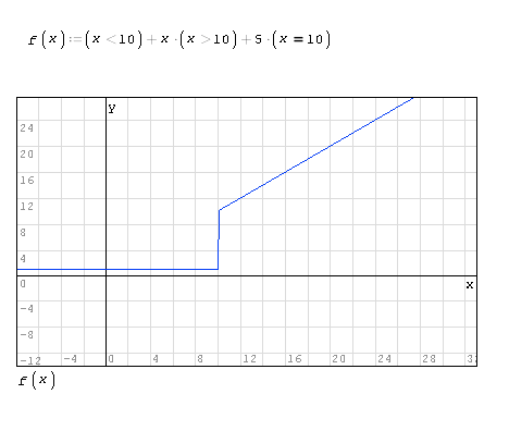

Hello!
I have a problem with simple equation. In case of my function, f(10) is equal to 5 but there is no "dot" of such value on the graph.
Please tell me how it should look like.
Where is the dot.sm (3.2 KiB) downloaded 1270 time(s).

Just point x=10 must be drawn

I think, that it is not proper solution. That "point" is already included in definition of the function, so why I should draw it manually. What in case, if the function is more complex and I don't know that there is such orphaned value in the middle of continous parts of function just from looking on the function definition. Your solution is correct in situation if we exactly know that there is such thing. It should be drawn on the graph somehow automatically, but it's not.

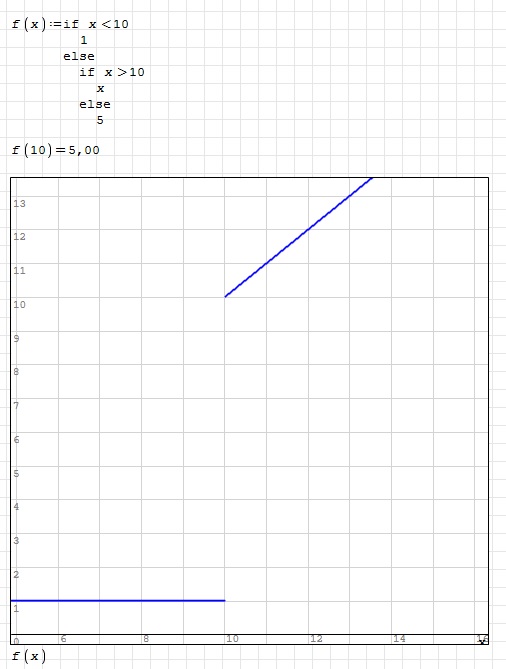

I think the issue is the auto-generated range does not include the point x=10 exactly and therefore never reaches the point where f(x) = 5. Simply allowing for some error as I've done in the attached solves the problem for me. Where is the dot (1).sm (3.85 KiB) downloaded 1247 time(s).
Another option, defining the range discretely.
Where is the dot discrete.sm (5.05 KiB) downloaded 1293 time(s).

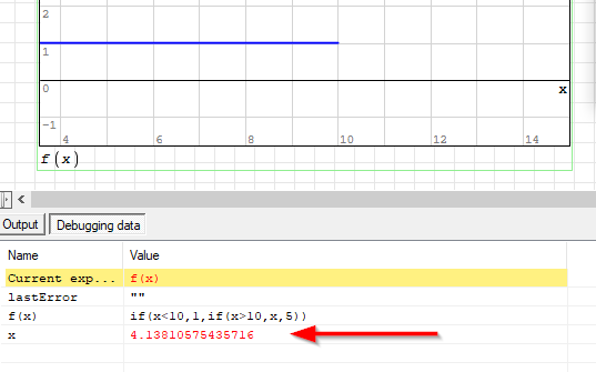

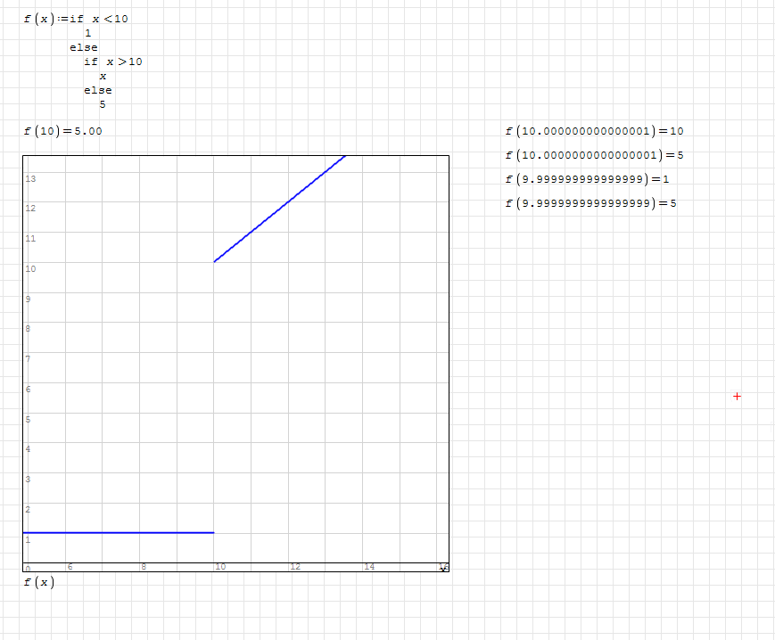

#6 Posted: 11/20/2018 3:09:48 PM
That's part of "the point". The function has to be drawn on the canvas, thus it is calculated for each pixel, and each pixel correspond to a value that depends on the range (first and last values visible), and even on the number of pixels (the width of the canvas).
You can figure it easily placing a breakpoint in the plot placeholder and looking at the values of x.
You must be very lucky to hit exactly 10.000000000000000 (15 digits)

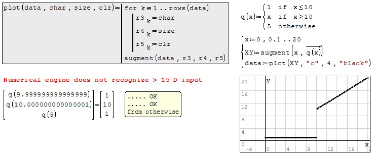

#8 Posted: 11/20/2018 4:14:02 PM
Your setup is not correct. Once in a while, undefined condition(s) do not reflect.
In very rare instances, it's the other way around, i.e: one of the condition must
be undefined wrt the algorithmic suite [typical => De Boor spline point].
Where is the dot discrete.sm (6.82 KiB) downloaded 1249 time(s).

the issue -in my modest opinion - is only on the plot side
Yes and no. You cannot really expect the program to know to evaluate/plot at a specific point for any arbitrary function. Additionally as shown in the figure below one can produce "incorrect" results by exploiting the fact that we're performing calculations on a discrete system.
It may seem like the plot "should" be able to detect an infinitesimal point at x=10, but what if we redefined it for x=pi or any arbitrary number. It becomes very difficult to find that single point discontinuity in the function.
I think in an instance like this, the user needs to either add some "fudge-factor" to the function or define the range manually to include the point(s) in question.

Hi. Yes, you can. With the normal issues for symbolic or numeric manipulations. And as frapuano talk, in some moment we need to implement some code for handle singularities. As an example, maybe too much specific, but about finite jumps, you can see
https://en.smath.info/forum/yaf_postst14910_Round.aspx and the implementation of discontinuous plots in round.sm (69.17 KiB) downloaded 1501 time(s).

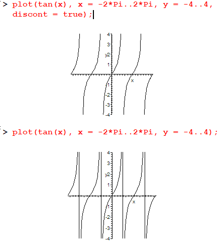

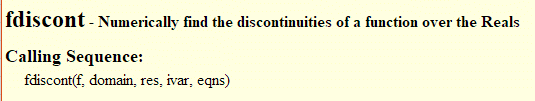

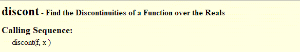

Maple have following functions, but need readlib for the following two:
Also can use this option for plots:
I see your point. I found a piecewise plotting example with removable discontinuity in maple here (need to scroll down).
A couple points to note. Generally, I don't think something like fdiscont would work for piecewise functions with single point discontinuities or perhaps even jump continuities. It mentions issues with these in the description.
I notice that both Maple and Matlab have "piecewise" functions. I assume that in those environments the "piecewise" functions may be an indicator to the "plot" function that specific conditions exist for which the function needs to be evaluated. Therefore the plot function will evaluate the boundary conditions.

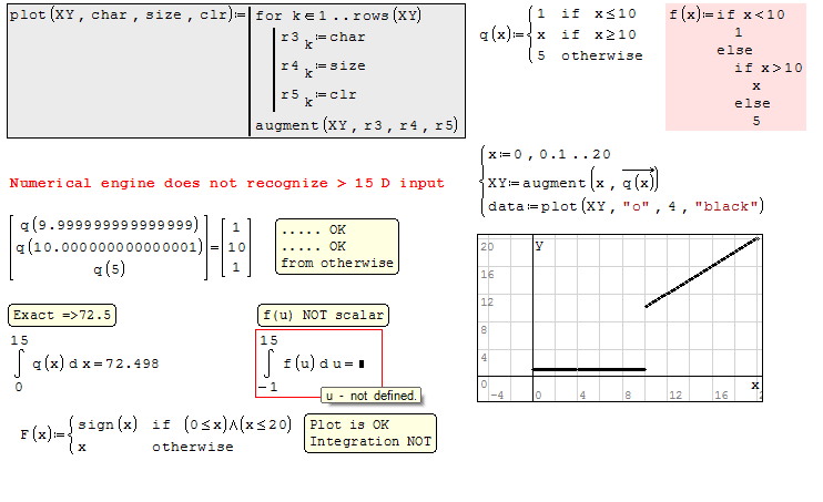

#14 Posted: 11/21/2018 1:04:22 PM
I'm not certain if it's necessary to indicate that a function is intended to be piecewise continous within SMath or if SMath is smart enough to determine intent by the structure of the function itself. I do not think, generally, any function with conditionals can be considered piecewise, but I'm not sure if that's true.
Mon ami, your point is SO fundamental
Those things appeared ad-nauseum in Mathsoft Collaboratory.
Mathcad up to 11, was a bit more understanding, but wrong by principle
because confusing because not telling the truth. A piece-wise function
MUST be specified completely. On that, Smath is absolutely correct.

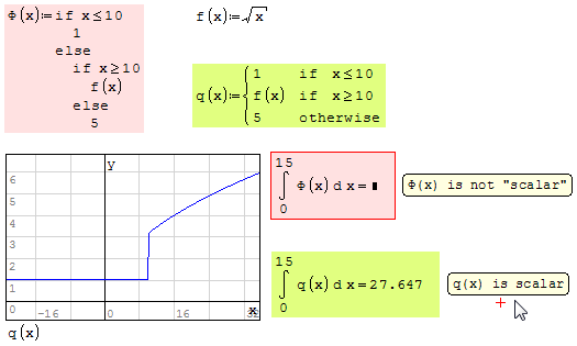

There are other things under the hood related to this discussion:
Integration of erf(x), and Gamma(x), the integrand must be vectorized.
Indirectly, it kind of depends upon of discontinuous approximation
of these two functions, the only two I have detected.
Most/most important about discontinuous is the major difference between
if/else and if/otherwise. Generally, they do the same but they aren't.
EXPLAIN: if/else is not scalar and it will not integrate a completely
specified if/else function. On the other hand, if/otherwise is scalar
thus will integrate. They both plot the same to add to the confusion.
Demonstrated => Integrate Discontinuous [Nuance].
Demonstrated => Where is the Dot Discrete.
It may even be more important if the path of integration is discontinuous.
Where is the dot discrete.sm (19.27 KiB) downloaded 1286 time(s).
Integrate Discontinuous [Nuance].sm (24.75 KiB) downloaded 1123 time(s).
