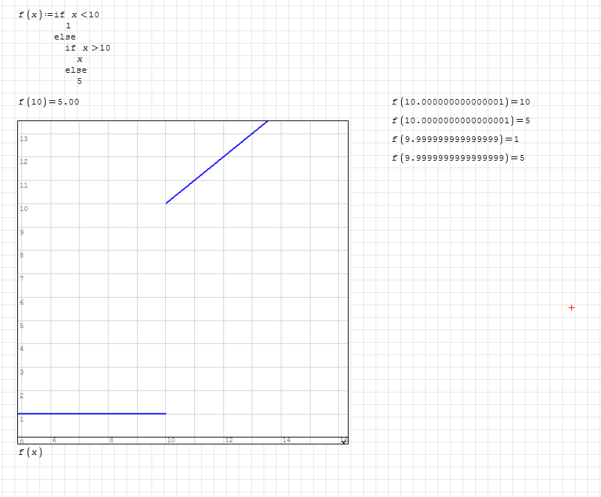

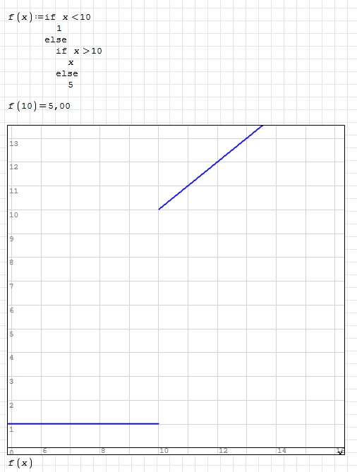

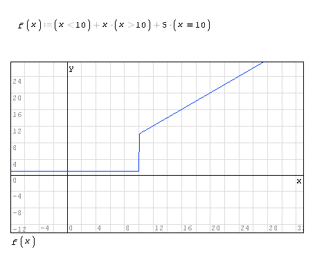

Hello!
I have a problem with simple equation. In case of my function, f(10) is equal to 5 but there is no "dot" of such value on the graph.
Please tell me how it should look like.
Where is the dot.sm (3,2 КиБ) скачан 1270 раз(а).

Just point x=10 must be drawn

I think, that it is not proper solution. That "point" is already included in definition of the function, so why I should draw it manually. What in case, if the function is more complex and I don't know that there is such orphaned value in the middle of continous parts of function just from looking on the function definition. Your solution is correct in situation if we exactly know that there is such thing. It should be drawn on the graph somehow automatically, but it's not.

I think the issue is the auto-generated range does not include the point x=10 exactly and therefore never reaches the point where f(x) = 5. Simply allowing for some error as I've done in the attached solves the problem for me. Where is the dot (1).sm (3,85 КиБ) скачан 1247 раз(а).
Another option, defining the range discretely.
Where is the dot discrete.sm (5,05 КиБ) скачан 1293 раз(а).

#6 Опубликовано: 20.11.2018 15:09:48

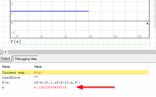

That's part of "the point". The function has to be drawn on the canvas, thus it is calculated for each pixel, and each pixel correspond to a value that depends on the range (first and last values visible), and even on the number of pixels (the width of the canvas).
You can figure it easily placing a breakpoint in the plot placeholder and looking at the values of x.
You must be very lucky to hit exactly 10.000000000000000 (15 digits)

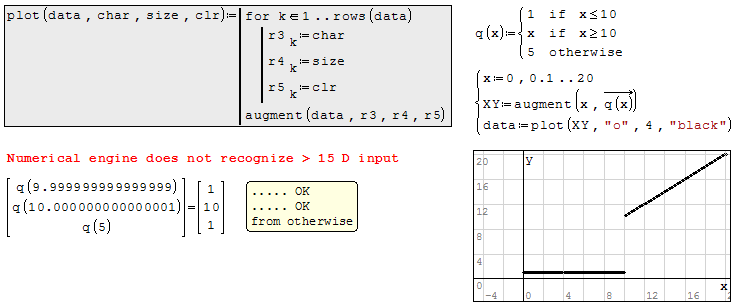

Hi. Yes, you can. With the normal issues for symbolic or numeric manipulations. And as frapuano talk, in some moment we need to implement some code for handle singularities. As an example, maybe too much specific, but about finite jumps, you can see
https://en.smath.info/forum/yaf_postst14910_Round.aspx and the implementation of discontinuous plots in round.sm (69,17 КиБ) скачан 1501 раз(а).

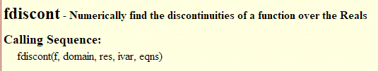

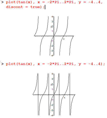

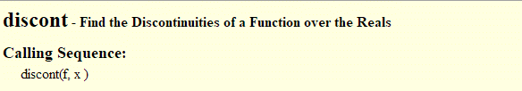

Maple have following functions, but need readlib for the following two:
Also can use this option for plots:
I see your point. I found a piecewise plotting example with removable discontinuity in maple here (need to scroll down).
A couple points to note. Generally, I don't think something like fdiscont would work for piecewise functions with single point discontinuities or perhaps even jump continuities. It mentions issues with these in the description.
I notice that both Maple and Matlab have "piecewise" functions. I assume that in those environments the "piecewise" functions may be an indicator to the "plot" function that specific conditions exist for which the function needs to be evaluated. Therefore the plot function will evaluate the boundary conditions.
Perhaps in SMath something similar could be implemented s.t. when a function is passed into the plot and it is specified as a piecewise function, it will evaluate any conditions specified within the range that aren't part of the auto-generated range.
I'm not certain if it's necessary to indicate that a function is intended to be piecewise continous within SMath or if SMath is smart enough to determine intent by the structure of the function itself. I do not think, generally, any function with conditionals can be considered piecewise, but I'm not sure if that's true.

Answer @ post # 8. Conditions are either true/false... Not maybe YES/maybe NO.

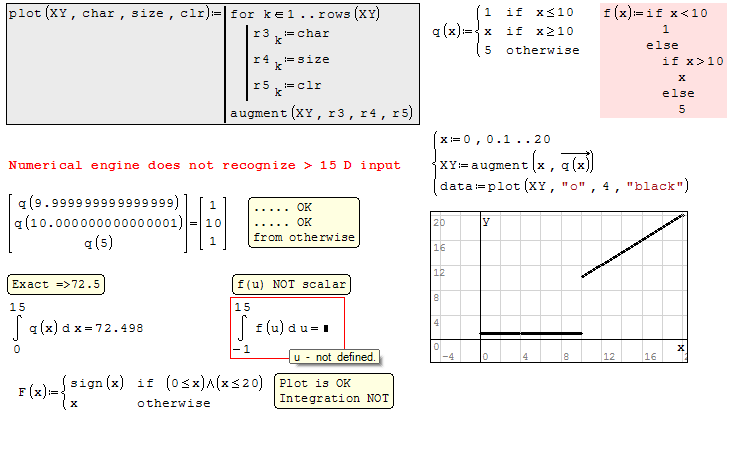

Those things appeared ad-nauseum in Mathsoft Collaboratory.
Mathcad up to 11, was a bit more understanding, but wrong by principle
because confusing because not telling the truth. A piece-wise function
MUST be specified completely. On that, Smath is absolutely correct.
There are other things under the hood related to this discussion:
Integration of erf(x), and Gamma(x), the integrand must be vectorized.
Indirectly, it kind of depends upon of discontinuous approximation
of these two functions, the only two I have detected.

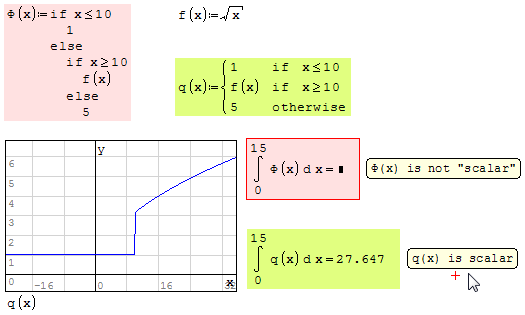

Most/most important about discontinuous is the major difference between
if/else and if/otherwise. Generally, they do the same but they aren't.
EXPLAIN: if/else is not scalar and it will not integrate a completely
specified if/else function. On the other hand, if/otherwise is scalar
thus will integrate. They both plot the same to add to the confusion.
Demonstrated => Integrate Discontinuous [Nuance].
Demonstrated => Where is the Dot Discrete.
It may even be more important if the path of integration is discontinuous.
Where is the dot discrete.sm (19,27 КиБ) скачан 1286 раз(а).
Integrate Discontinuous [Nuance].sm (24,75 КиБ) скачан 1123 раз(а).

The same plot in Mathcad will shows no apparent break @ 5.
Mathcad plots on ½ pica thus plots straight lines, thus not fine/pleasant look.
Smath plots on pixel thus the discontinuous were there is no ½ pixel.
A scalar function is a function that runs on a vanishing iterator 'x' .
Smath does not calculate ln(,), exp(,) ... it fetches from Windows.
Most if not all functions are approximations of 21 decimals.
i.e: Normalized Padé Rational Fractions.
Result may be only 18 Decimals. Thus, by convention results are
truncated to 15 decimals. Symbolic Engines is another story.
High accuracy Main-Frames may run Chebyshev of very high numerical
stability 25 decimals [typical Clenshaw ...]
Normalized Rational Fraction approximates on various best range wrt
to minimal arithmetic operations. Each function has its own specific range
generally very small. More numerical maths kind of scale the base range
to accommodate the 'x' of greater value than the base approximation,
naturally up to the max of the result < 10^307.
Before the event of rational approximations the first IBM used
continued fraction for the principal ln(x), exp(x), sqrt(x) ...
Can't help more about unknown math suite/use of the proposal.
#20 Опубликовано: 23.11.2018 01:42:43
math suite ...
...in the if/otherwise '5' has no meaning.
Backspace to delete 5, type ".
