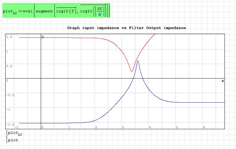

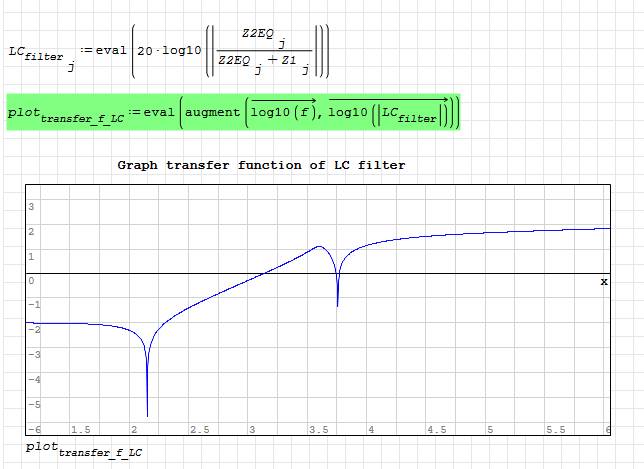

When I downloaded the version that had those edits it showed that exact graph that you have posted.

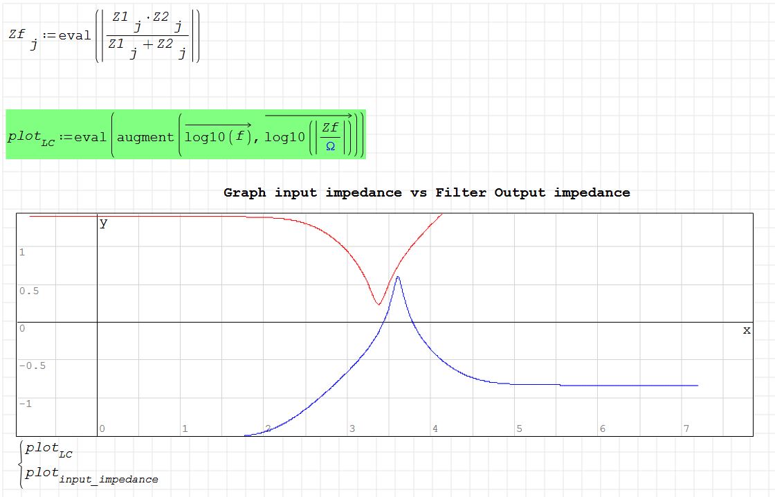

However, whenever I leave the values as i had them without vectoring them get the expected graph, which matches the TI app note. (see picture)
Now what really confuses me the Transfer function plot looks so different. I input it as the App note stated however the graph seems "negated" as opposed to what I would expect.
Any Ideas Ya'll?
Thanks in advance,
Carlo

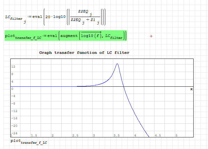

Hi Carlo. You take twice log10. Just augment log10(f) and LC.filter.

Hi. Not in that plot, in the previous:
Bad: Two logs:
Ok: One log:

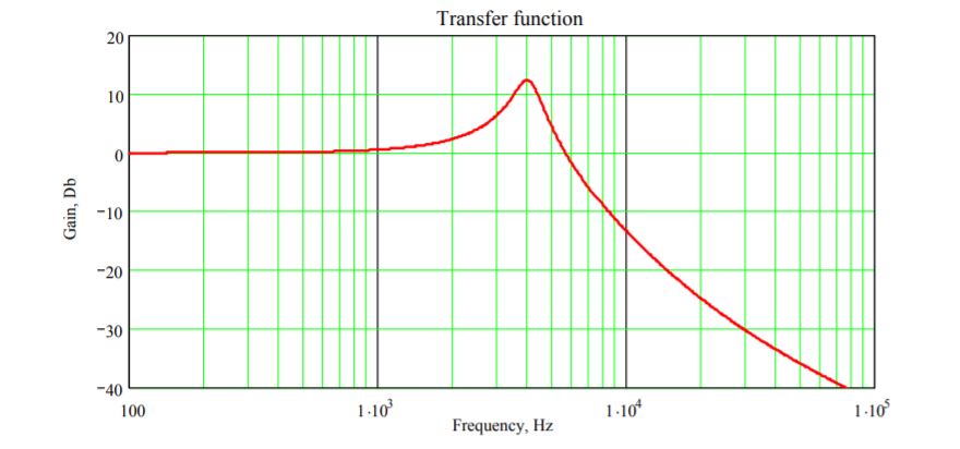

This other have the same shape, and seems to have the same values than the mathcad plot in the TI app note. Notice that this plot is log only in the x-axis, and the y axis isn't in the log scale in the plot just because you're plotting in dB
The last plot is log in both x and y axis. See the difference in the green lines. So, you correctly take there here log for both axis
Bad: Two logs:
Ok: One log:

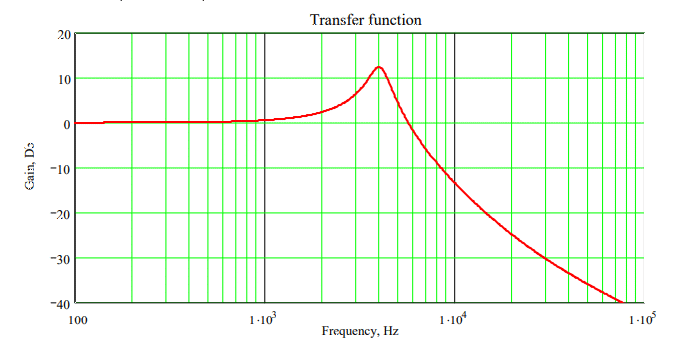

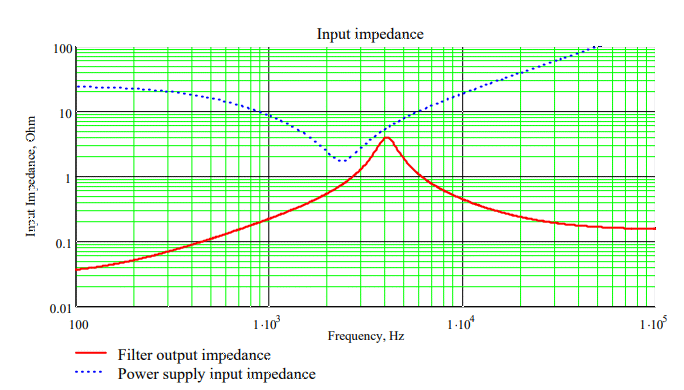

#12 Posted: 1/29/2020 12:26:59 AM
Thanks to Jean and Razonar I believe we can close this thread up! At least as it pertains to graphing indexed values.
The resulting file may be found here for reference:
HELPED_Input_Filter_Test_V1.sm (87.91 KiB) downloaded 1222 time(s).
I have opened a thread here:
Log based X and Y graph thread
This will be an attempt to get my graphs to look more like the following
But hopefully without that horrible green.
