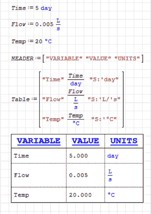

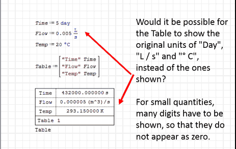

Will it be possible?
Units_Table.sm (7.85 KiB) downloaded 856 time(s).
Carlos

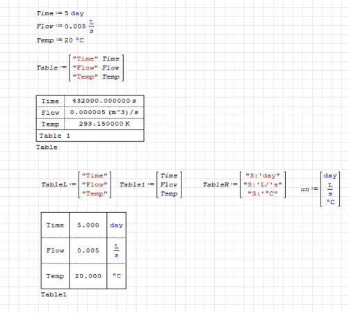

#2 Posted: 3/21/2018 4:51:14 PM
120 likes in 337 posts.
sets the header and units matrices
Davide Carpi 3/22/2018 8:17:00 AM

Thanks Sergio:
You made me remember the solution that Martin Kraska gave me, but I can not put a header on it.
Do you have any suggestion?
Units_Table_r2.sm (15.19 KiB) downloaded 897 time(s).
Carlos

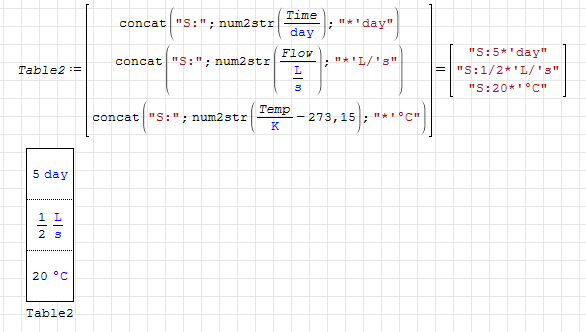

#4 Posted: 3/22/2018 6:35:19 AM
I thought about this (string manipulation)
but num2strtransforms into fractions

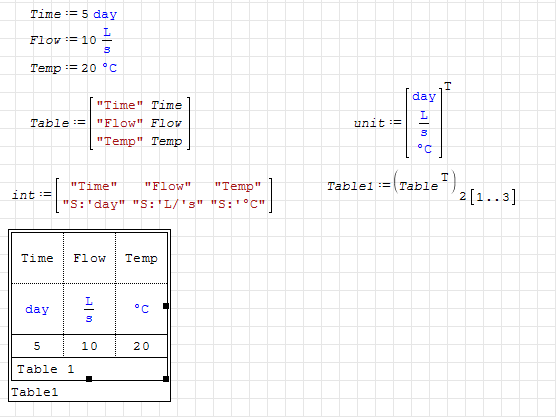

#5 Posted: 3/22/2018 1:36:09 PM
I prefer the way we did in 1987, collecting piles of fluids information.
Units_Table Preference.sm (12.43 KiB) downloaded 922 time(s).
#6 Posted: 3/22/2018 1:44:41 PM
1,332 likes in 2,241 posts.
Use var2str() from CustomFunctions instead
sergio 3/22/2018 2:07:00 PM, frapuano 3/22/2018 5:29:00 PM

Thank you very much to everyone for your help,
I already managed to make the table as I required it.
Units_Table_r3.sm (9.19 KiB) downloaded 913 time(s).

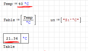

#9 Posted: 6/26/2018 6:32:55 PM
26 likes in 155 posts.
CBG,
Using the unit summary to convert units back to original units doesn't work for temperature conversions. What you are doing with the units summary assumes the conversion is a factored multiplier. It works great for everything except temperature (or any other unit doesn't scale by a factored multiplier).
#10 Posted: 6/26/2018 9:28:04 PM
Just define those units.
#11 Posted: 6/26/2018 9:49:54 PM
Jean Giraud,
Maybe try something other than 20 deg?...
