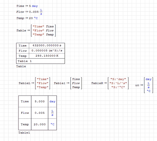

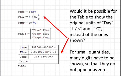

Will it be possible?
Units_Table.sm (7,85 КиБ) скачан 855 раз(а).

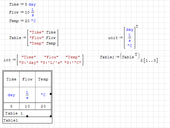

Thanks Sergio:
You made me remember the solution that Martin Kraska gave me, but I can not put a header on it.
Do you have any suggestion?
Units_Table_r2.sm (15,19 КиБ) скачан 896 раз(а).

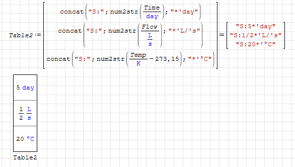

I thought about this (string manipulation)
but num2strtransforms into fractions
Use var2str() from CustomFunctions instead

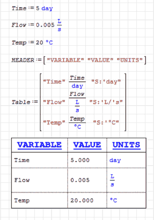

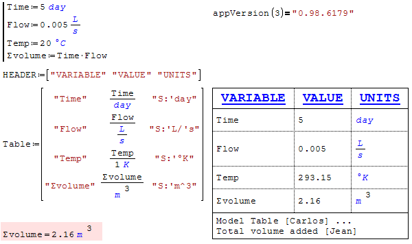

Thank you very much to everyone for your help,
I already managed to make the table as I required it.
Units_Table_r3.sm (9,19 КиБ) скачан 912 раз(а).

CBG,

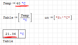

Using the unit summary to convert units back to original units doesn't work for temperature conversions. What you are doing with the units summary assumes the conversion is a factored multiplier. It works great for everything except temperature (or any other unit doesn't scale by a factored multiplier).

Jean Giraud,
Maybe try something other than 20 deg?...

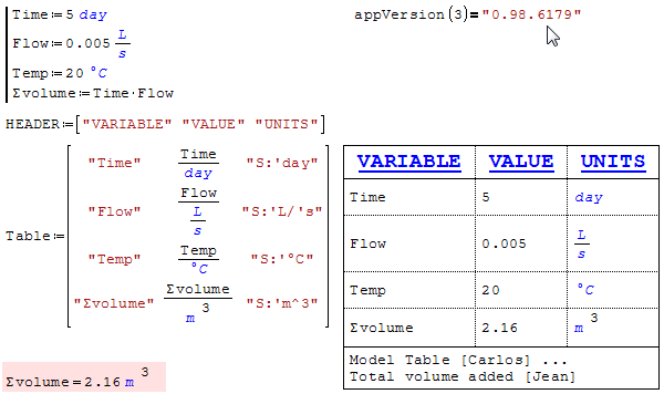

Version: 0.99(build: 6671)
#12 Опубликовано: 26.06.2018 23:59:58
You are quite right and there are two things here
1. As it looks, the °C can't be made user.
The unit system is grounded on 'K', bloody pest to me.
2. The other thing is the Shadow in context, a real bug.
It worked fine from Carlos original [by what coincidence ?]
Not changing the context, context reproduces. Changing context
and the all thing °C gets freaked. I observed that many times
in Smath. In fact, very problematic.
Thanks for this wise observation.
Table Region Carlos.sm (10,6 КиБ) скачан 877 раз(а).
