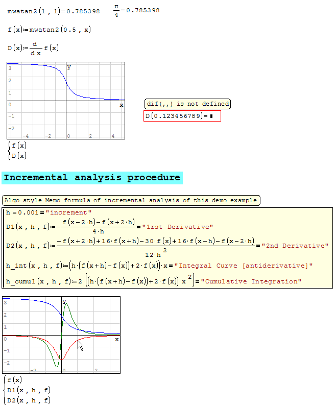

#12 Posted: 6/5/2016 8:58:58 PM
Hi Mike. I prefer this other, but have some round inconvenients:
#13 Posted: 6/5/2016 9:04:35 PM
Mike Kaganski
Mike Kaganski
184 likes in 434 posts.
I guess that with the new try function samebody can make a good one atan2.
But with try, it won't differentiate again.
С уважением, Михаил Каганский
#14 Posted: 6/5/2016 9:10:02 PM
Oh, I think that this happen only to me :-). Not very sure that try don't accept diff.
So, this with numerical optimization must to be the best solution (until atan2 not be in SMath):
#15 Posted: 6/5/2016 9:24:33 PM
Mike Kaganski
Mike Kaganski
It's a good option, and only ~30% slower.
#16 Posted: 6/6/2016 10:11:40 AM
Like this Alvaro: look for the Matlb code in the f(x) menu,
look for mwatan2 ... if you have in your version: then go
Maths atan2.sm (10.93 KiB) downloaded 1255 time(s).
