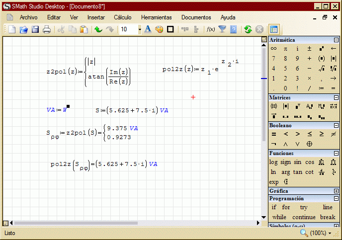

Mike,
The xy2pol does not work when units are included:
Do we agree?
When eventually it is working:
The units of the "Magnitude" and the units of the angle, (for the case of complex numbers here), will be different.
Note: I see you got W(att) how?
I see that you have a semicolon ( ; ) I have a comma (,).
Re(S);Im(S) versus Re(S),Im(S)
Basile

WroteMike,
Do we agree?
Yes we do
Yes, that's what I show in my screenshot, that uses ≡ instead of =, just to show the desired result: seeing is better than reading.
ЦитатаNote: I see you got W(att) how?
Now I suppose it's apparent: Ctrl+= and manually make system with desired result
Russian locale default settings
С уважением,
Михаил Каганский

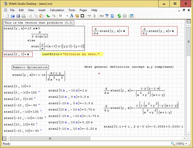

WroteNotice that atan2 ins't in SMath, which is more correct than atan for this functions (see http://www.mathworks.com/help/matlab/ref/atan2.html for example).
atan2.sm (35,42 КиБ) скачан 1217 раз(а).
С уважением,
Михаил Каганский
Hi Mike. I prefer this other, but have some round inconvenients:
WroteI guess that with the new try function samebody can make a good one atan2.
But with try, it won't differentiate again.
С уважением,
Михаил Каганский
WroteWroteI guess that with the new try function samebody can make a good one atan2.
Oh, I think that this happen only to me :-). Not very sure that try don't accept diff.
So, this with numerical optimization must to be the best solution (until atan2 not be in SMath):
It's a good option, and only ~30% slower.
С уважением,
Михаил Каганский

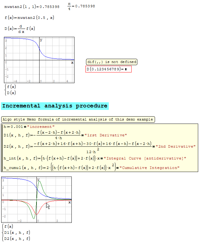

Like this Alvaro: look for the Matlb code in the f(x) menu,
look for mwatan2 ... if you have in your version: then go
Maths atan2.sm (10,93 КиБ) скачан 1253 раз(а).
