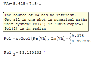

#2 Опубликовано: 05.06.2016 13:34:47

#4 Опубликовано: 05.06.2016 15:14:46
Better be in harmony wth the maths and Smath.
There is nothing to look gain, Smath is OK.
The Magnitude (length) and The Angle (angle) in polar coordinates have different units.
For sure they have different units: one is in "UnitGraph" the other is in "rad"
The rad is not a common unit. It is not correct.
YES: rad is correct, rad is the maths unit in trig approximations as well as in official tables.
If you want °: convert by appending ° in the Smath result

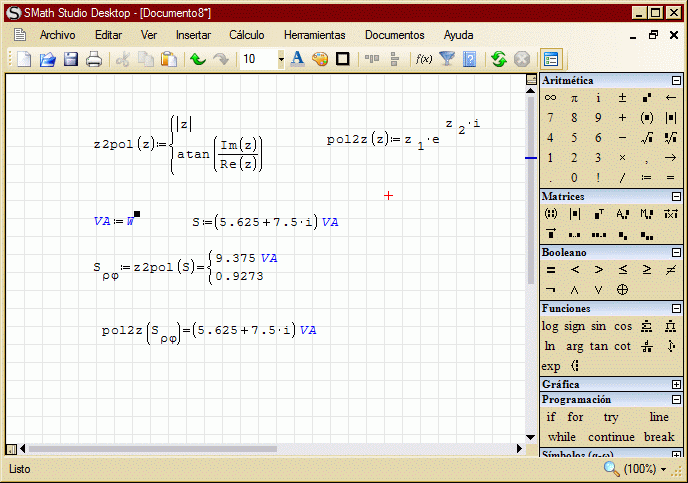

#7 Опубликовано: 05.06.2016 17:52:10
Basile
Basile
Mike,
The xy2pol does not work when units are included:
Do we agree?
When eventually it is working:
The units of the "Magnitude" and the units of the angle, (for the case of complex numbers here), will be different.
Note: I see you got W(att) how?
I see that you have a semicolon ( ; ) I have a comma (,).
Re(S);Im(S) versus Re(S),Im(S)
Basile

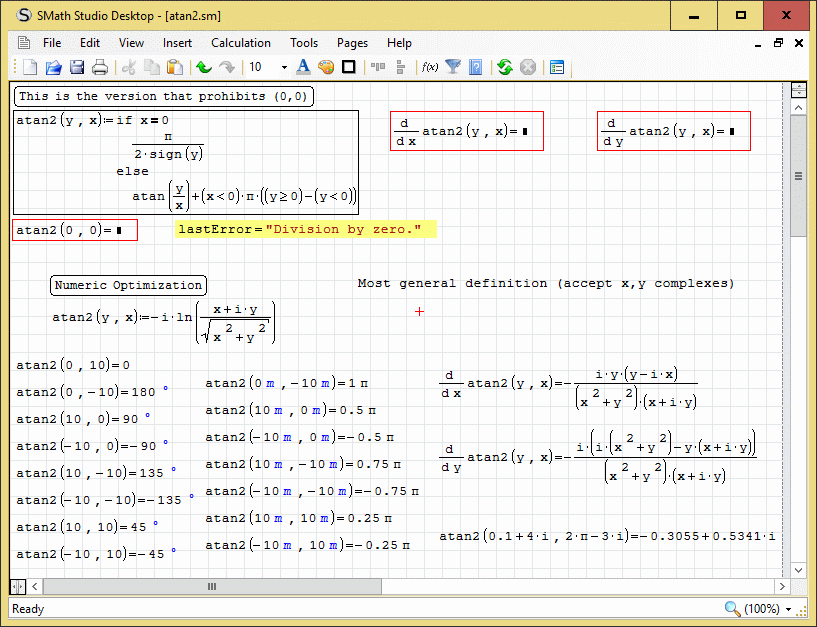

#8 Опубликовано: 05.06.2016 19:26:10
Something like that?
Notice that atan2 ins't in SMath, which is more correct than atan for this functions (see http://www.mathworks.com/help/matlab/ref/atan2.html for example).
Davide Carpi 05.06.2016 19:28:00
#9 Опубликовано: 05.06.2016 19:55:50
Mike Kaganski
Mike Kaganski
Mike,
Do we agree?
Yes we do
Yes, that's what I show in my screenshot, that uses ≡ instead of =, just to show the desired result: seeing is better than reading.
Now I suppose it's apparent: Ctrl+= and manually make system with desired result
Russian locale default settings
С уважением, Михаил Каганский
#10 Опубликовано: 05.06.2016 19:57:34
In this specific set of applications I have no interest in "numerical MathEMATICS". [Basile]
From A...Z, Smath is a numerical math tool as any other CAS and including your specific application.
xy2pol result is a vector of two components that need no unit as they are implicit. Extract each
component and append a dead unit decoration for clarity to yourself and the reader.
#11 Опубликовано: 05.06.2016 20:03:39
Mike Kaganski
Mike Kaganski
atan2.sm (35,42 КиБ) скачан 1217 раз(а).
#12 Опубликовано: 05.06.2016 20:58:58
Hi Mike. I prefer this other, but have some round inconvenients:
#13 Опубликовано: 05.06.2016 21:04:35
Mike Kaganski
Mike Kaganski
I guess that with the new try function samebody can make a good one atan2.
But with try, it won't differentiate again.

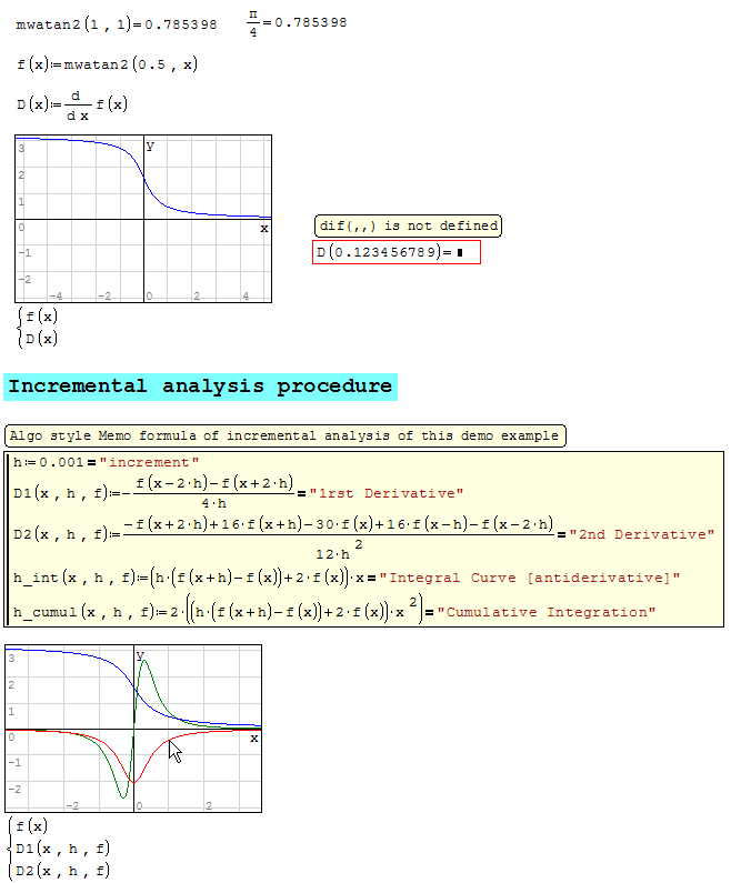

#16 Опубликовано: 06.06.2016 10:11:40
Like this Alvaro: look for the Matlb code in the f(x) menu,
look for mwatan2 ... if you have in your version: then go
Maths atan2.sm (10,93 КиБ) скачан 1253 раз(а).
