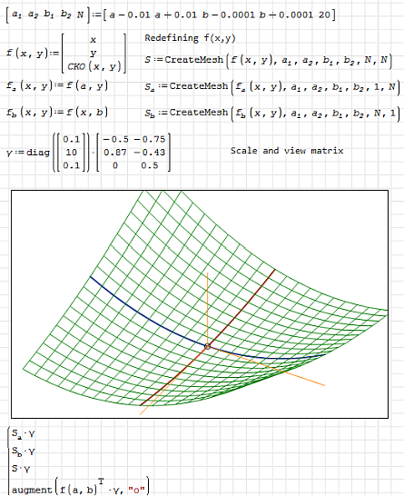

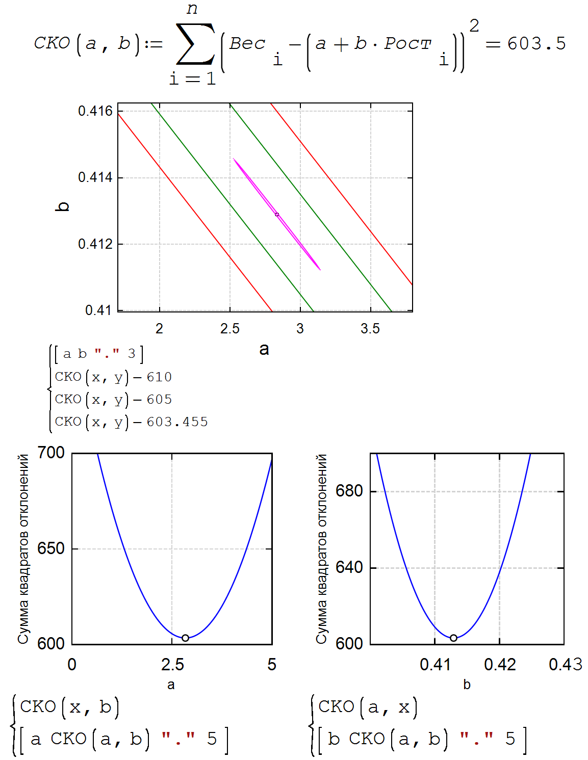

SMath Forum SMath Studio Questions 3D plot CKO(a, b) 1 Pages (4 items) 3D plot CKO(a, b) - I have two 2D plots, but not one 3D plot - Messages Go to last post #1 Posted: 10/12/2023 4:26:52 AM Valery Ochkov 66 likes in 697 posts. Group: User I have two 2D plots, but not one 3D plot with the minimum point.Help please!6-1-Mister-Class.sm (21.77 KiB) downloaded 1308 time(s). #2 Posted: 10/12/2023 5:09:09 AM Alvaro 1,125 likes in 1,798 posts. Group: User Hi Valery. This is a way.6-1-Mister-Class.sm (27.39 KiB) downloaded 1293 time(s).Best regards.Alvaro. 1 users liked this postValery Ochkov 10/12/2023 5:43:00 AM #3 Posted: 10/12/2023 5:44:46 AM Valery Ochkov 66 likes in 697 posts. Group: User WroteHi Valery. This is a way.6-1-Mister-Class.sm (27.39 KiB) downloaded 1293 time(s).Best regards.Alvaro.Thanks, but better so - a counter plot6-1-Mister-Class.sm (30.03 KiB) downloaded 1272 time(s). #4 Posted: 10/12/2023 2:47:57 PM Alvaro 1,125 likes in 1,798 posts. Group: User Hi. Choosing CKO as z and using small ranges.6-1-Mister-Class 3D.sm (41.91 KiB) downloaded 1306 time(s).Best regards.Alvaro. 1 users liked this postValery Ochkov 10/12/2023 2:53:00 PM 1 Pages (4 items) New Posts No New Posts
