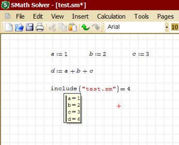

Hi. I think what the user request is a function similar to "clear all" in Matlab.
Given that include is capable of collecting all the names of the variables of a worksheet as the "whos" command of Matlab would do, perhaps the include code can be used to implement the option to delete all the variables with Clear( "all" ) or something similar.

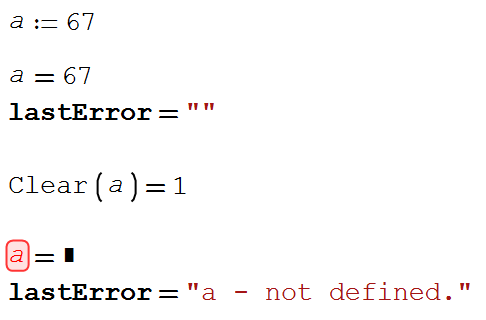

#6 Posted: 10/17/2021 7:41:24 AM
is there any function to remove all declared variables? similar to Clear
Clear(■,■,■,■,■) ...
clears the system in cause [variables, vectors, matrices]
Clear(x,y,z,m,ω)=1 are evaporated from the system.
Page17 Clear.sm (15.52 KiB) downloaded 1512 time(s).

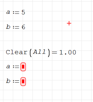

Hy,
is there any update on such a "Clear(All)" function?
Would be really helpful to have it like this
a:=5
b:=6
Clear(All):=1
a=?
b=?
Thanks for answers
BG

#17 Posted: 10/9/2023 6:45:04 AM
CustomFunctions plugin
direct link: link removed (now the extensions manager works again)
3 users liked this post
Oscar Campo 10/9/2023 7:38:00 AM, Arie 10/9/2023 10:58:00 AM, overlord 10/9/2023 6:20:00 PM
#18 Posted: 10/9/2023 6:23:22 PM
598 likes in 1,380 posts.
This works!!!
Thanks for the beta update.
What would you think about revising output string?
Instead of "1", it can be;
arg==1 --> "All cleared"
arg==2 --> "Variables cleared"
arg==3 --> "Functions cleared"
Oscar Campo 10/9/2023 8:25:00 PM
#19 Posted: 10/10/2023 11:54:52 AM
This works!!!
You're welcome, glad it seems to work correctly on first try. I still have to check carefully the (2)nd option, since as it is now it deletes "anything that is not a function" (including some low-level stuff).
Usually I prefer a binary output, since can be used inside if/else functions independently from localizations, future enhancements of descriptions, and string comparision issues.
I'll think about it.
