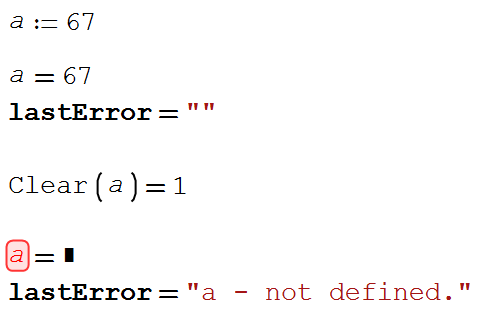

You can install the "Special Functions" plugin, which has a Clear() function as you need.
Actually this plug-in is built-in into the installer package.

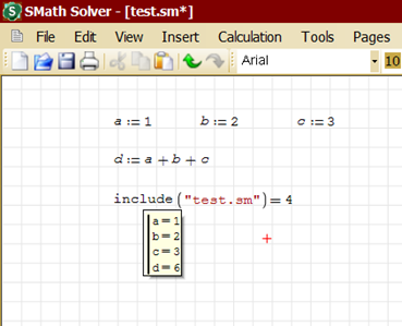

Hi. I think what the user request is a function similar to "clear all" in Matlab.
Given that include is capable of collecting all the names of the variables of a worksheet as the "whos" command of Matlab would do, perhaps the include code can be used to implement the option to delete all the variables with Clear( "all" ) or something similar.

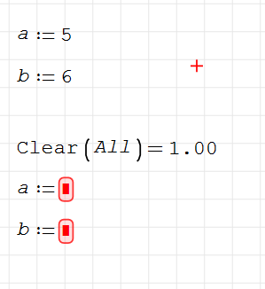

is there any update on such a "Clear(All)" function?
Would be really helpful to have it like this
a:=5
b:=6
Clear(All):=1
a=?
b=?
Thanks for answers

This works!!!
Thanks for the beta update.
What would you think about revising output string?
Instead of "1", it can be;
arg==1 --> "All cleared"
arg==2 --> "Variables cleared"
arg==3 --> "Functions cleared"

#19 Опубликовано: 10.10.2023 11:54:52
This works!!!
You're welcome, glad it seems to work correctly on first try. I still have to check carefully the (2)nd option, since as it is now it deletes "anything that is not a function" (including some low-level stuff).
