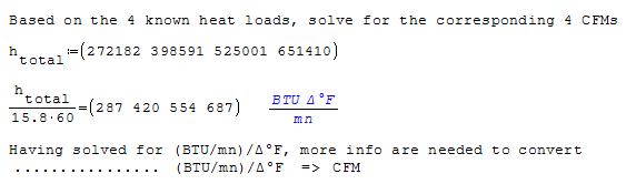

Before applying some suite, you must have something to process.
With only two temp. BTU means nothing. Two values are missing.
With the two you provide: who knows to what BTU rate they apply ?

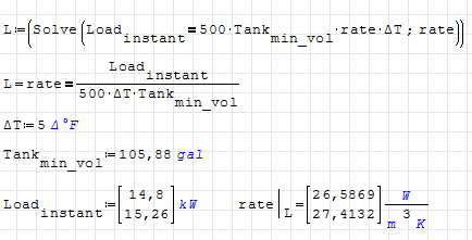

#4 Posted: 4/18/2016 5:22:30 PM
Maybe like this ?

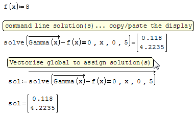

Follow up on this post. On 0.98.6398, I am now seeing a problem where assigning the solve block to a variable fails. solve block 2.smz (2.53 KiB) downloaded 1114 time(s).
#13 Posted: 8/3/2017 4:19:33 PM
Solve() from the Maxima plugin
solve%20block%202.sm (4.91 KiB) downloaded 1175 time(s).
#14 Posted: 8/3/2017 5:04:27 PM
Ruben Sidranski
Ruben Sidranski
17 likes in 465 posts.
mkraska - Thank you, but not what I was looking for. I have the power already calculated/known ... I am looking to solve for a rate of time. As you can see in my example, the program will solve as long as I do NOT define the solve block with a variable. It also looks like you are using the Maple plugin.
Update, I thought that Vectorize eliminated the nesting issue. I think that is what is going on as my solution may be a nested item and not a matrix. Definitely a nesting issue. How do I "un-nest" a Vectorized equation? Solve Block 2.smz (2.87 KiB) downloaded 1120 time(s).without jMG Matrix manipulation. I was hoping Vectorize would simplify the issue.
#15 Posted: 8/4/2017 10:55:57 AM
The solve block is not compatible for assigning objects that are vectorized.
This was first noticed solving Gamma(x), that solves un-assigned.
erf(x), Gamma(x) are two reported, that solve from vectorising, not assignable.
Nothing to do => copy/pate ... Does not spool to file either
ElSid 8/4/2017 2:50:00 PM

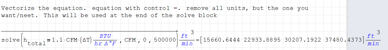

#19 Posted: 8/4/2017 10:29:03 PM
That' the best I can do.
1. Subscript should not exist [complicate matters].
2. What are "Units" doing in Engineering works ?
solve block 2 Examine Solutions.sm (7.26 KiB) downloaded 1081 time(s).
