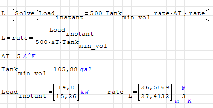

Doing something wrong ...
Trying to solve empirical formula with matrix input using either solve or maple(solve)Solve Block.sm (12,98 КиБ) скачан 1021 раз(а).

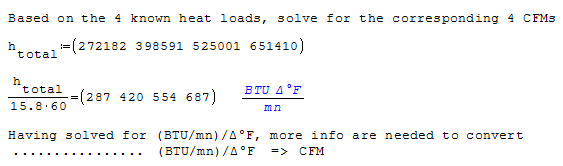

Before applying some suite, you must have something to process.
With only two temp. BTU means nothing. Two values are missing.
With the two you provide: who knows to what BTU rate they apply ?

I'm not sure why would you need the solve() when you may directly calculate the result as you did,
but here it goes Solve Block.sm (7,95 КиБ) скачан 1041 раз(а).
solve() cannot find units, so you need to "help" it allowing it to search for unitless values and adding required units by hands. Also, it cannot search matrices - so iterate it (I used vectorize() ).
Third - you need to pay attention when you use assignments, and when - comparisons. You happened to use := in solve() instead of ≡.

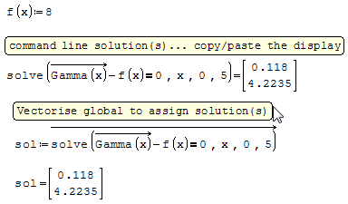

The solve block is not compatible for assigning objects that are vectorized.
This was first noticed solving Gamma(x), that solves un-assigned.
erf(x), Gamma(x) are two reported, that solve from vectorising, not assignable.
Nothing to do => copy/pate ... Does not spool to file either

As explained before => Gamma(x) is one that needs be vectorised locally
That does not exclude global vectorising for further use, downstream the document.

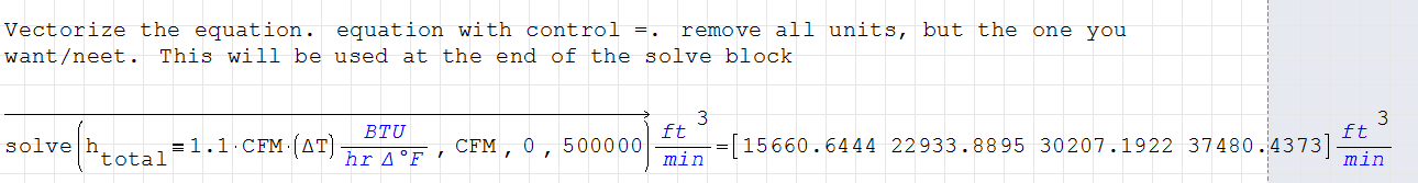

#19 Опубликовано: 04.08.2017 22:29:03
That' the best I can do.
1. Subscript should not exist [complicate matters].
2. What are "Units" doing in Engineering works ?
solve block 2 Examine Solutions.sm (7,26 КиБ) скачан 970 раз(а).

Finally, an example that shows WHY we need units the items in the array are in kW and need to be in BTU/hr for the empiracle equation to be valid. If I split the array like you did, it does what i need ... wondering why I cannot do it with vectorize Solve Block 2a.smz (4,41 КиБ) скачан 1016 раз(а).
