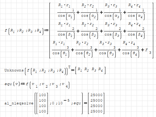

Usually al_nleqsolve() is more capable at this kind of situations.
Also your functions shouldn't have boolean operations.

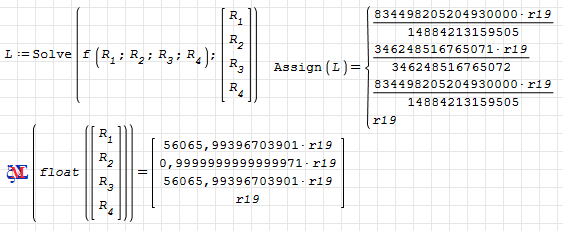

Solve() from the Maxima plugin can handle under-determined systems of equations. In such cases, the solution contains a free variable. The name changes every time the sheet is recalculated. If you want to rely on that name, insert a MaximaControl("restart" ) command to reset the Maxima session and the counter.

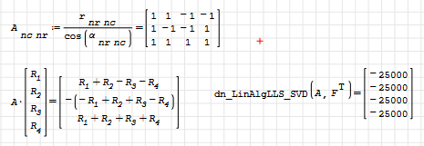

Hi. Can you share the Mathcad result? This page is the help for matlab techniques for handling underdetermined systems: https://www.mathworks.com/help/matlab/math/systems-of-linear-equations.html#bt7ov7u
Writing the system as a linear one, SMath have some functions for work with those systems, like this one
Trial.sm (61.84 KiB) downloaded 1584 time(s).
