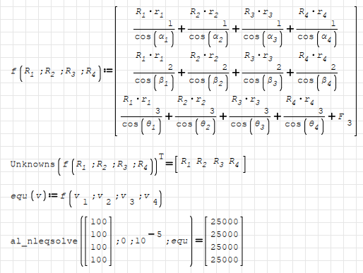

Hello All,
I have four unknowns in three linear equations. In this setup, can the FindRoot function get values for these variables?
I tried the same in MathCAD and could get the solution, but it is not working in Smath.
Can someone guide me, please?
Are there other possible solving methods for handling such equations with 6 or 8 unknowns?

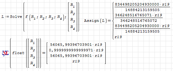

Solve() from the Maxima plugin can handle under-determined systems of equations. In such cases, the solution contains a free variable. The name changes every time the sheet is recalculated. If you want to rely on that name, insert a MaximaControl("restart" ) command to reset the Maxima session and the counter.

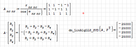

Writing the system as a linear one, SMath have some functions for work with those systems, like this one
Trial.sm (61,84 КиБ) скачан 1583 раз(а).
For your f(x,y,z) ... I get two sets of solved [x,y,z].
Smath solves the Mathsoft example, 4 unknowns.
Smath Butller is lot more advanced/difficult.
Jean.
Solve FindRoot f(x,y,z) ITERATIVE.sm (103,87 КиБ) скачан 1746 раз(а).
