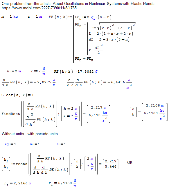

#1 Posted: 5/18/2023 2:52:16 AM
Valery Ochkov
Valery Ochkov
66 likes in 690 posts.

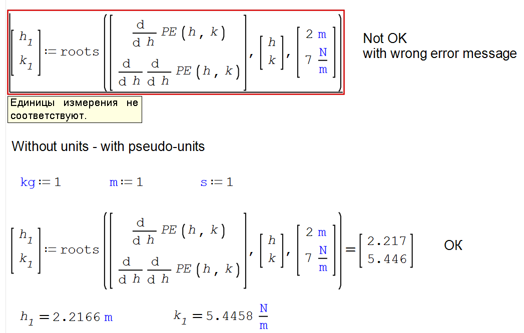

Can Roots and Solve functions work with units?
See please the attach!2-4-OOO-Plots-DD.sm (14.94 KiB) downloaded 1216 time(s).

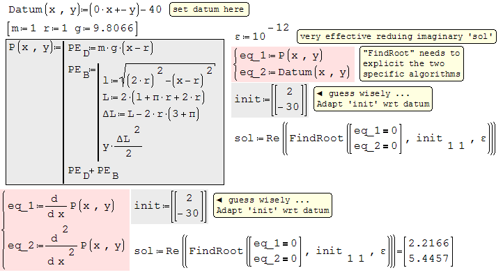

#5 Posted: 5/18/2023 11:49:19 AM
1,123 likes in 1,795 posts.
There are several ways to handle units with SMath roots. This is one of them, where the units are sterilized (Pompelmo' dixit) locally, instead of globally.
2-4-OOO-Plots-DD.sm (12.96 KiB) downloaded 1190 time(s).
Thank you, but this is very difficult for me.
The question was simple: Roots & Units.

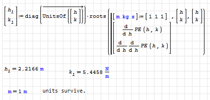

#7 Posted: 5/19/2023 8:08:52 PM
1,355 likes in 2,270 posts.
It is simple, if you use Findroot()
2-4-OOO-Plots-DD_Kr.sm (16.37 KiB) downloaded 1207 time(s).

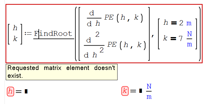

#8 Posted: 5/20/2023 2:28:48 AM
Valery Ochkov
Valery Ochkov
Why?
#9 Posted: 5/20/2023 7:29:49 PM
Why ?... Not coded as per the plugin instruction code.

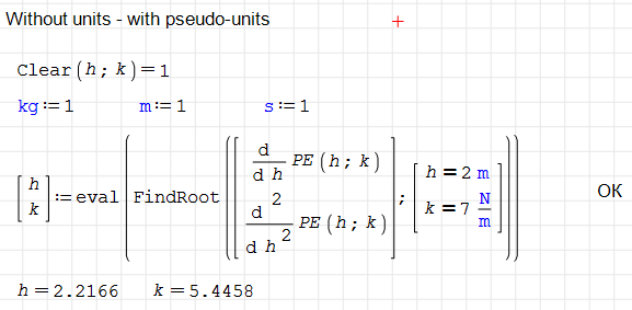

#10 Posted: 5/20/2023 8:02:35 PM
598 likes in 1,379 posts.
Why?
Use eval(), sometimes it resolves problems.
Especially it is useful on some solver situations.
