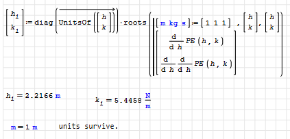

There are several ways to handle units with SMath roots. This is one of them, where the units are sterilized (Pompelmo' dixit) locally, instead of globally.
2-4-OOO-Plots-DD.sm (12,96 КиБ) скачан 1190 раз(а).

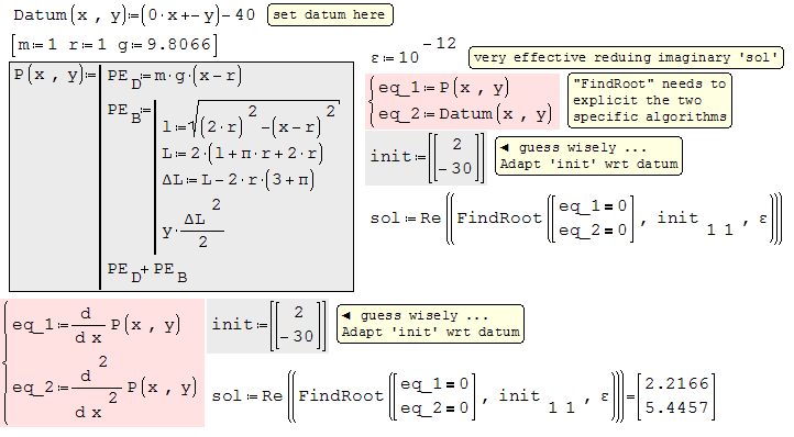

It is simple, if you use Findroot()
2-4-OOO-Plots-DD_Kr.sm (16,37 КиБ) скачан 1207 раз(а).

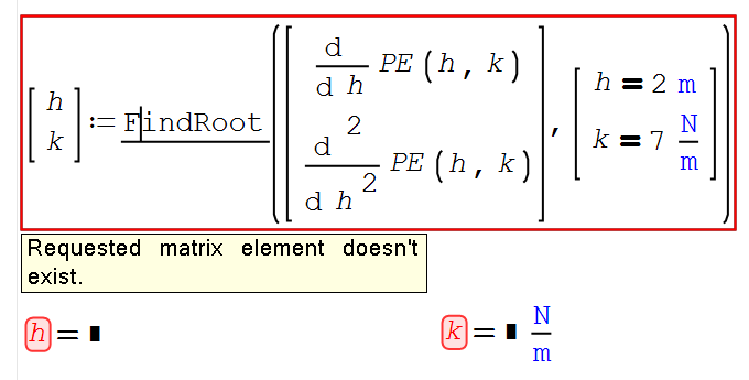

Why?
#9 Опубликовано: 20.05.2023 19:29:49
Why ?... Not coded as per the plugin instruction code.
