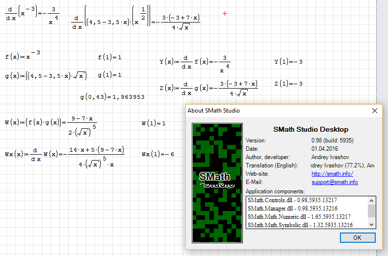

#3 Posted: 4/5/2016 12:07:16 PM
Alexander O. Melnik
Alexander O. Melnik
127 likes in 498 posts.
Пожалуйста поправьте ошибку, появившуюся после версии 097-5890
Прикрепи .SM файл с ошибкой к сообщению... Видишь, у Михаила все работает и сложно разобраться что к чему (то есть в проге ли ошибка или в твоем документе)

#5 Posted: 4/6/2016 12:58:56 AM
CBG
CBG
78 likes in 312 posts.

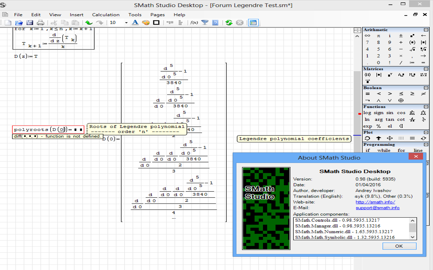

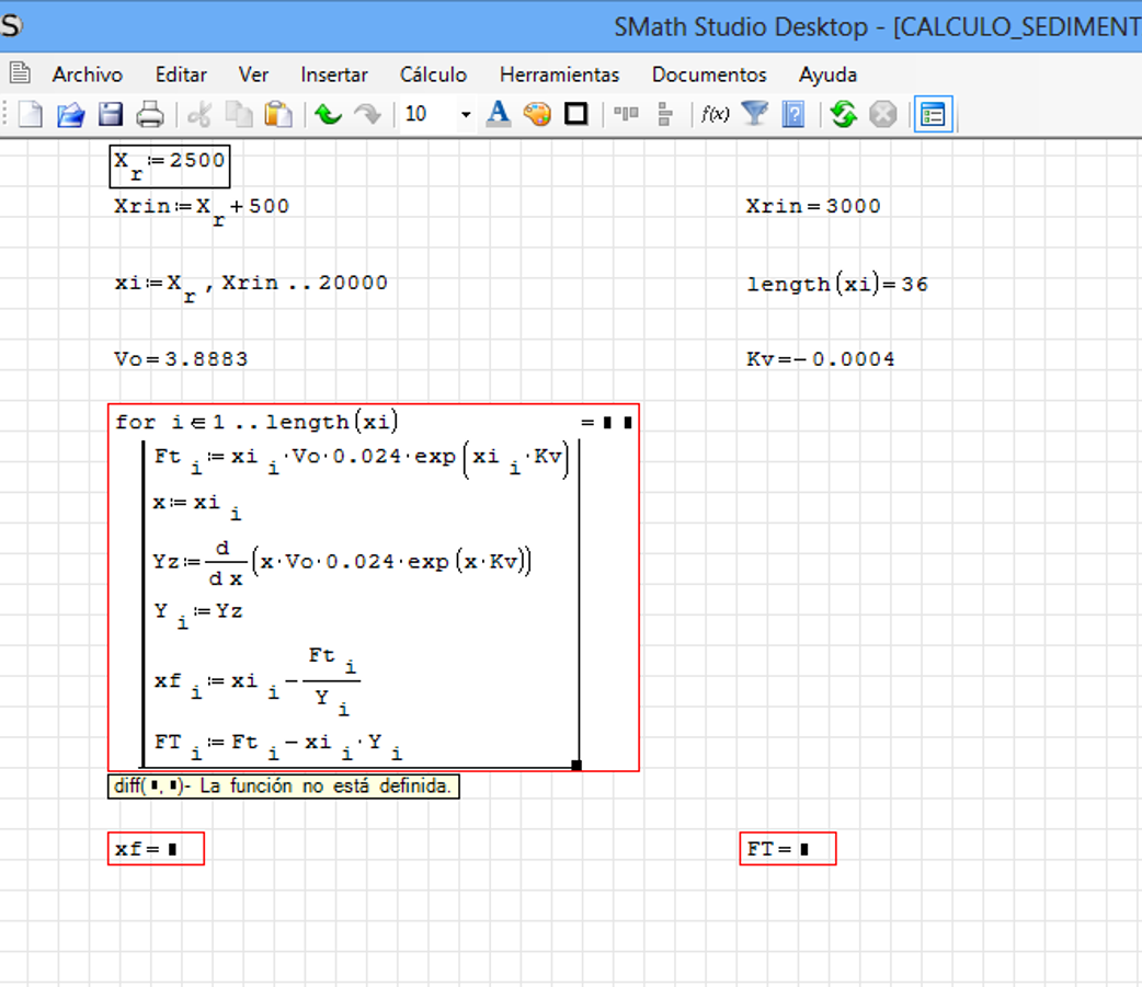

In the new version of Smath Studio ( 0.98 5935 ) , the "diff" function does not work properly, and gives the following error : diff () function is not defined.
#6 Posted: 4/6/2016 1:04:15 AM
Mike Kaganski
Mike Kaganski
184 likes in 434 posts.
Could you guys please check if a plugin causes that? Does disabling plugins solve the problem?

#7 Posted: 4/6/2016 1:29:08 AM
CBG
CBG
This worked very well with the previous version of Studio Smath with the same plugins that I have installed.
#8 Posted: 4/6/2016 1:43:59 AM
Mike Kaganski
Mike Kaganski
The question isn't in if it worked before. The question is, if this is some plugin, then its maintainer should update it, because it apparently is broken. Bare SMath's diff works well (at least in some installations, e.g. mine, with English locale). So, could you check if you can fix the problem turning off some plugin, and if yes, then which plugin is that?

mikekaganki : I disable all plugins, and the problem persists .
It seems to be a bug in the new version

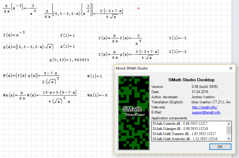

#14 Posted: 4/6/2016 1:03:46 PM
NDTM Amarasekera
NDTM Amarasekera
130 likes in 352 posts.

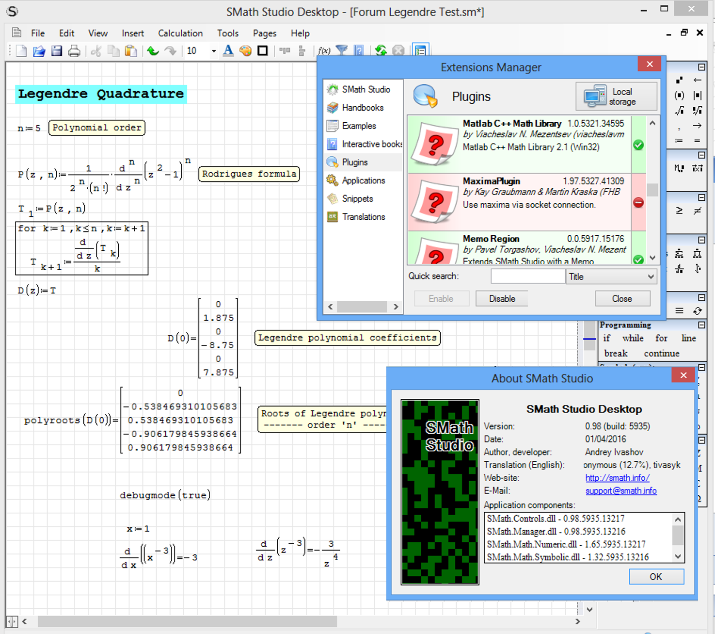

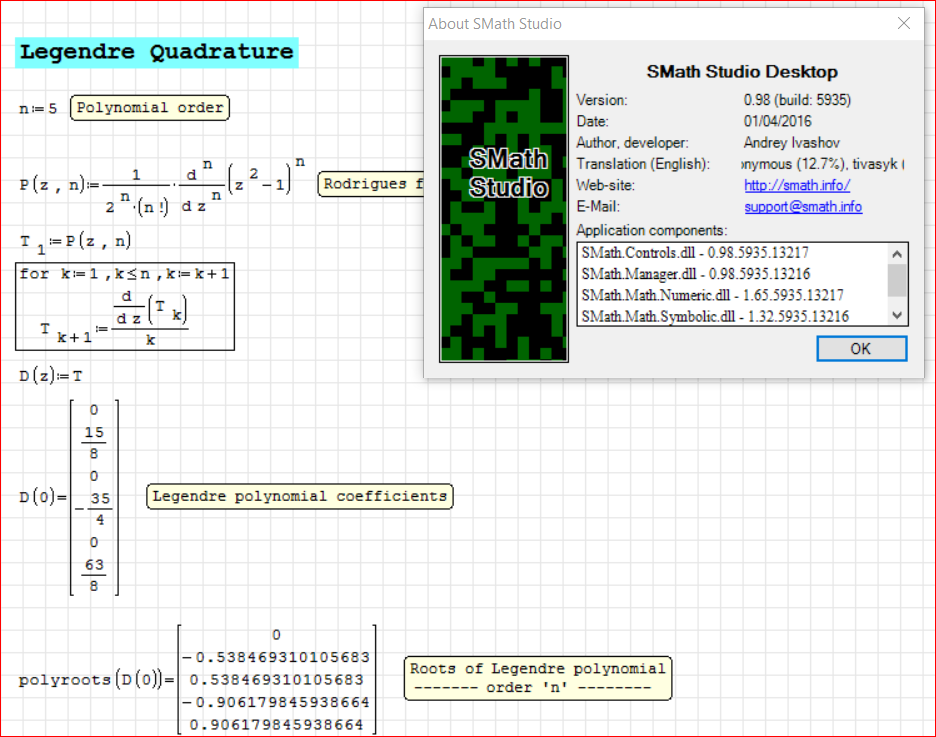

It works for me in SS 98.5935.

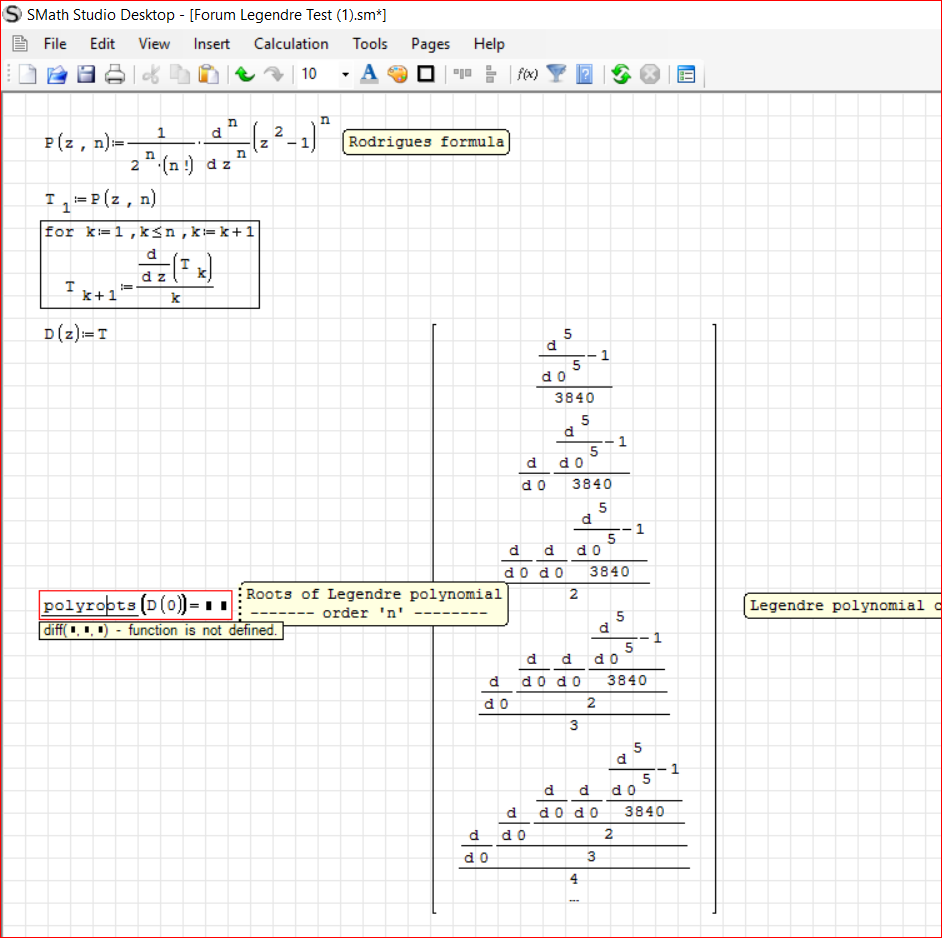

Hi Jean,
Thanks.
The culprit is the Maxima plugin. We have to delete this plug in to get your program to run correctly.
If the plugin is disabled and then re-calculated, the program will run correct.
However, disabling is not effective, as the error will re-appear when the program is reloaded.
The error is reproduced below.
3 users liked this post
Andrey Ivashov 4/6/2016 2:16:00 PM, Fridel Selitsky 4/6/2016 2:19:00 PM, sergio 4/6/2016 4:07:00 PM

I found the fault, this is caused by the Maxima Plugin.
I Disable it , and Smath Studio works perfectly .
Mikekaganki was right .
