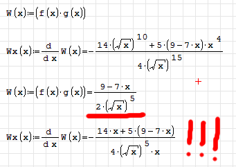

[SS-2311][MAXIMA] Why doesn't work in 0.98? - Сообщения
#1 Опубликовано: 05.04.2016 07:25:16
Василий Николаевич Храмушин
Пожалуйста поправьте ошибку, появившуюся после версии 097-5890
#2 Опубликовано: 05.04.2016 08:24:49
Mike Kaganski
Mike Kaganski

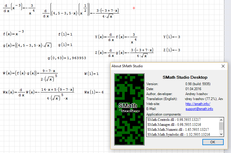

ЧЯДНТ?
Actually, I see another strange thing, that nevertheless, doesn't change results: If I show result immediately on assignment, following derivative optimizes differently.
С уважением, Михаил Каганский

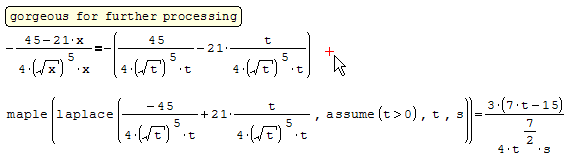

#4 Опубликовано: 05.04.2016 12:23:32

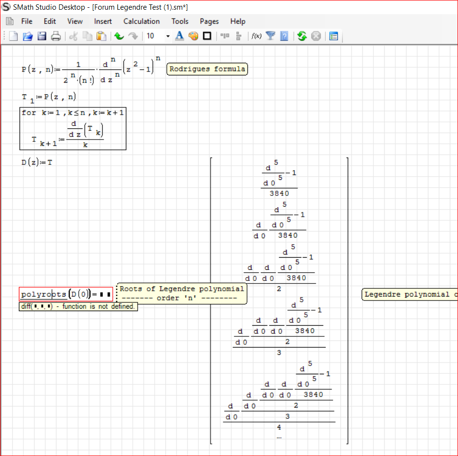

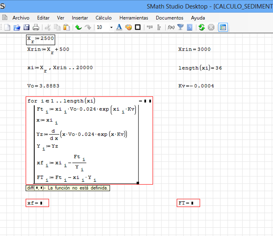

In the new version of Smath Studio ( 0.98 5935 ) , the "diff" function does not work properly, and gives the following error : diff () function is not defined.
I confirm. I already wrote about it
http://en.smath.info/forum/yaf_postst7423_Jacobi-matrix-can-not-find-the-numerical-result.aspx
My animation programs do not work in Smath 0.98 5935 , as Smath 0.98 5935 does not recognize the coding of the Jacobi
matrix.
http://en.smath.info/forum/yaf_postst2307_Method-A-B--Draghilev-and-animation-spatial-mechanisms.aspx
http://en.smath.info/forum/yaf_postst2734_Animation-of-mechanisms-with-two-or-more-degrees-of-freedom.aspx

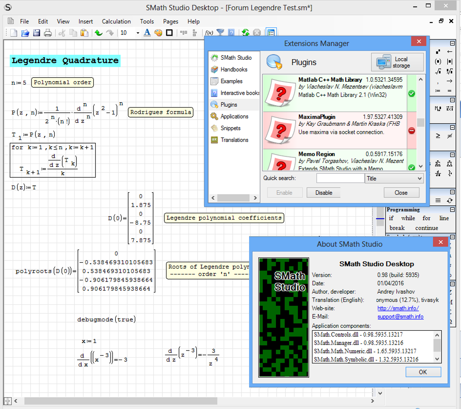

#12 Опубликовано: 06.04.2016 12:49:09
CBG
CBG
Jeand Giraud:
Your "Forum Legendre Test.sm", file does not work correctly in the current version of SMath Studio that I have installed.

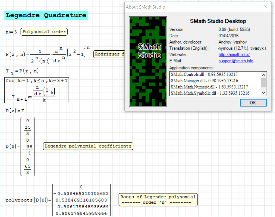

#14 Опубликовано: 06.04.2016 13:03:46
NDTM Amarasekera
NDTM Amarasekera
It works for me in SS 98.5935.
Thanks "CBG" for reporting. In Smath 5346 it does not go further than order 5,
it might ... but next century ! I was wise to tabulate "wr" the wi & roots.

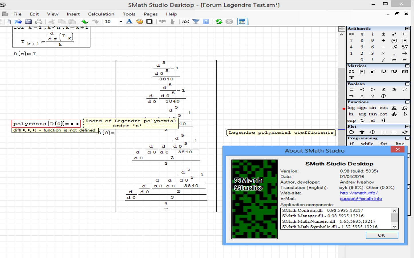

#18 Опубликовано: 06.04.2016 13:51:27
NDTM Amarasekera
NDTM Amarasekera
Hi Jean,
Thanks.
The culprit is the Maxima plugin. We have to delete this plug in to get your program to run correctly.
If the plugin is disabled and then re-calculated, the program will run correct.
However, disabling is not effective, as the error will re-appear when the program is reloaded.
The error is reproduced below.
Andrey Ivashov 06.04.2016 14:16:00, Fridel Selitsky 06.04.2016 14:19:00, sergio 06.04.2016 16:07:00
#19 Опубликовано: 06.04.2016 14:12:25
CBG
CBG
I found the fault, this is caused by the Maxima Plugin.
I Disable it , and Smath Studio works perfectly .
Mikekaganki was right .
Thanks and regards
to all
CBG
