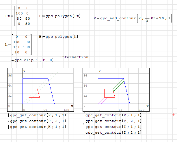

In regards to hatch and fill - do we have a Smath code that can hatch a closed polygon?

#33 Posted: 3/29/2017 9:58:50 AM
Try the gpc wrapper plugin by davide
GPC.sm (6.8 KiB) downloaded 1817 time(s).
