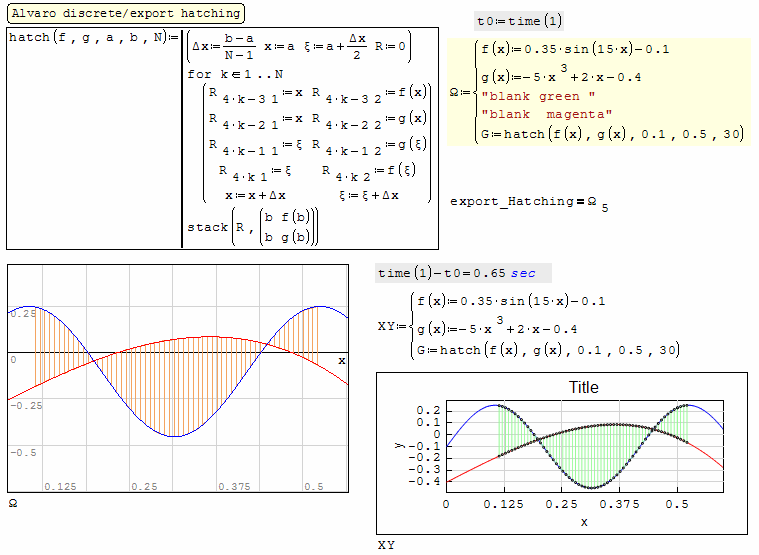

#18 Posted: 6/6/2016 4:34:38 AM
My versions for fill and hatch.
Have a nice day.
FillRnd.sm (44.23 KiB) downloaded 1607 time(s).
#19 Posted: 6/6/2016 9:39:37 AM
Only the first module works. The ones "if/else" do not in Smath 5346
The first module is fully compatible with Maxima X_Y plot, i.e:
traces color, symbols, hatching color ... great for publishing.
Martin scalar hatching is slightly faster, not to account in project.
Your module [Alvaro] is great for extracting a particular bar but
couldn't add to the plot ???
Tanks, Jean
2DPlots Hatch Demo [Martin, Alvaro].sm (23.45 KiB) downloaded 1377 time(s).

Well, works fine in last nightly build, but you're right, in others don't. I try to modify, but have a lot of issues. For instance, attached seems to work in last portable version, but can take a very long time for fill(phi(2), ...) , I suspect for some problem with the lele function. I'm interested in that function and rfill because rows of G are proportional to double integral of the functions f,g.
About the original fill function, it is a very nice job, but I prefer to define x range and Nx, Ny as number of points, instead of define the entire box x1,x2,y1,y2. But that's is ok for double integrals.
