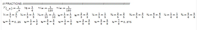

#5 Posted: 10/21/2022 11:57:51 AM

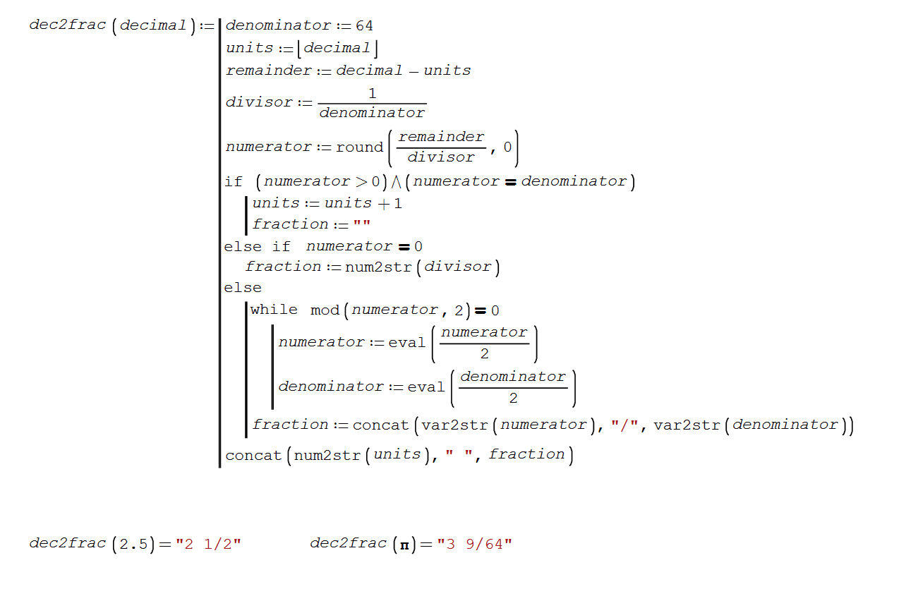

#6 Posted: 10/21/2022 12:15:46 PM
WroteNatural fractions. How can I enter a value to display the integer and fractional part, like 2½. Maybe somewhere there is a full-fledged Help?
Maybe this can help:
dec2frac.sm (6.59 KiB) downloaded 1117 time(s).

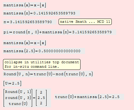

#7 Posted: 10/22/2022 8:55:34 AM
... lat brick in the wall from not acknowledged.
Stuff Forum.sm (12.14 KiB) downloaded 1167 time(s).
#8 Posted: 10/24/2022 9:55:59 PM
"dec2frac(decimal)" Works for me! Thank you! I've been using a sheet from MathCad, which is not as clear:
