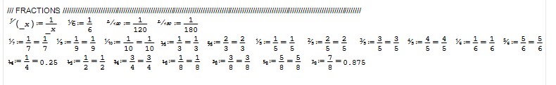

If you wish for special characters (e.g., 「½」) to be treated as a number, you can declare then as such:
½:0.5
      There are a few of these fraction characters you can define as a variable:

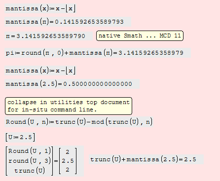

How can I enter a value to display the integer and fractional part
... make it algo style utility.

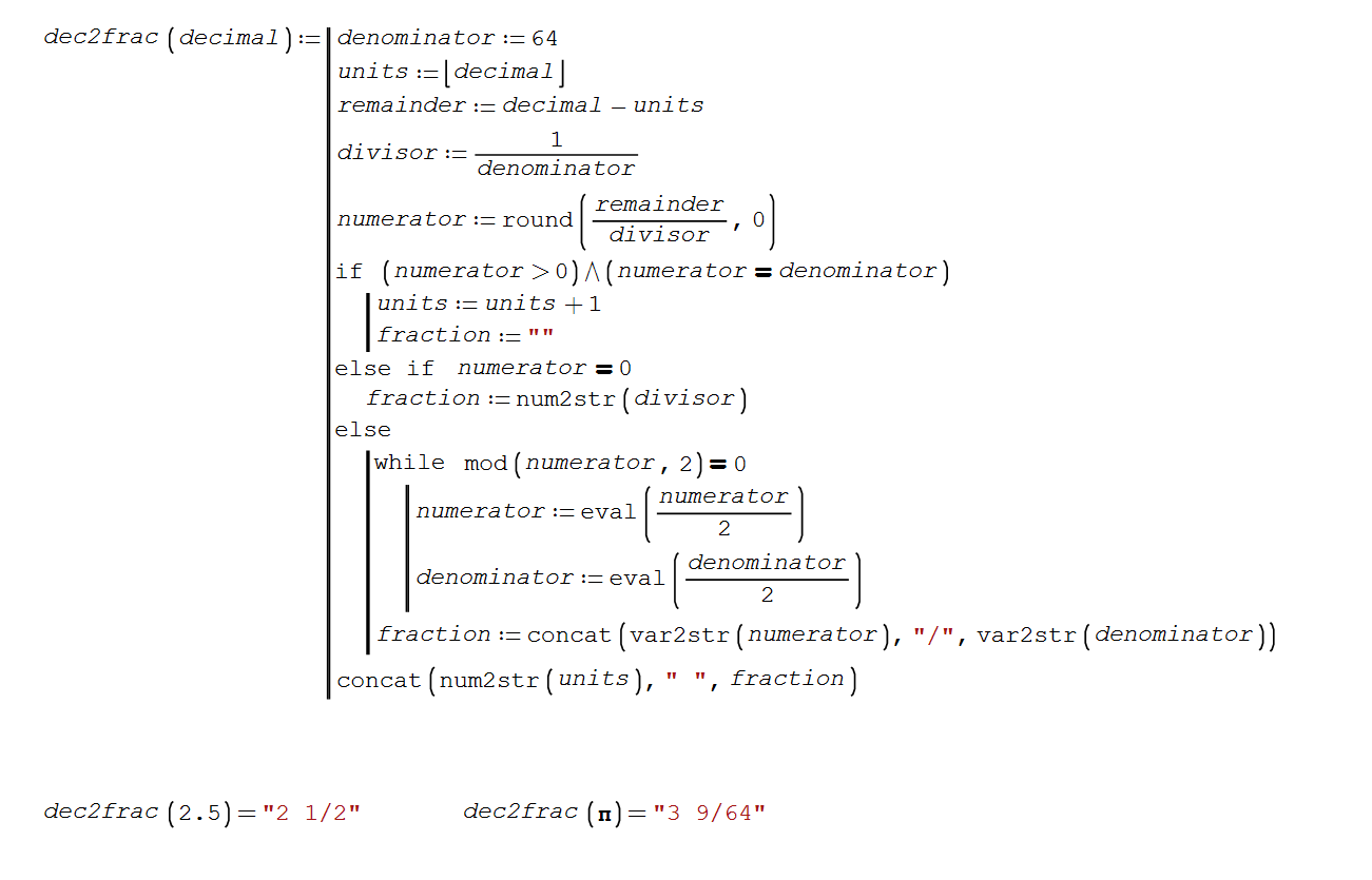

Maybe this can help:
dec2frac.sm (6,59 КиБ) скачан 821 раз(а).

"dec2frac(decimal)" Works for me! Thank you! I've been using a sheet from MathCad, which is not as clear:

Even the Oscar's solution is very elegant, this is another approach, based on the Nasch work.
