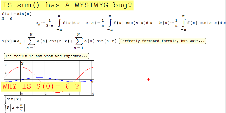

I was writing an example of Fourier series when I encounter a misleading display with the sum() function. Here is the setup:
Look at the attached file for full setup and findings.
ISERROR QUESTION MARK_B.sm (17 KiB) downloaded 83 time(s).
I understand the case, and I don't have a solution for that. I just wanted others to save time finding what is happening here.
One way I discovered this behavior was by trying to select only the right part of the formula, the action always selected this part:
Guy

S(0)≡S1(0)≡S2(0)≡0 ... No error wrt the 3 different constructions.
Try save under another name, close PC, open new session.
As you report it looks there is shadow in the construction context.
ISERROR QUESTION MARK_B.sm (18 KiB) downloaded 75 time(s).

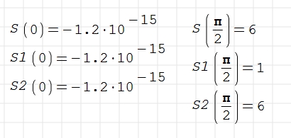

There is a behavior that I realized while playing with sMath. When you place the cursor in front of the operator, sMath underlined the operator and all of its operants:
If I were attentive enough, I could of found what was happening a lot faster...
When you are inside a operator, sMath underline only the inside operator:
For the sake of intuitivity, I guest adding the "Excel parenthesis" behavior would of enlightened me
Guy

You are right, S(0)=S1(0)=S2(0)=0
Guy
