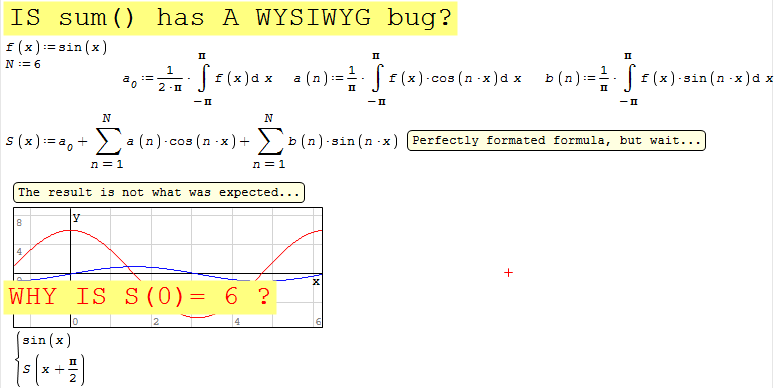

I was writing an example of Fourier series when I encounter a misleading display with the sum() function. Here is the setup:
![2019-05-09 11_30_56-SMath Studio - [ISERROR QUESTION MARK_B.sm_].png](/en-US/files/Download/qze7hq/2019-05-09-11_30_56-SMath-Studio---[ISERROR-QUESTION-MARK_B.sm_].png)
Look at the attached file for full setup and findings.
ISERROR QUESTION MARK_B.sm (17.61 KiB) downloaded 1168 time(s).
I understand the case, and I don't have a solution for that. I just wanted others to save time finding what is happening here.
One way I discovered this behavior was by trying to select only the right part of the formula, the action always selected this part:
![2019-05-09 11_32_22-SMath Studio - [ISERROR QUESTION MARK_B.sm].png](/en-US/files/Download/NvKqre/2019-05-09-11_32_22-SMath-Studio---[ISERROR-QUESTION-MARK_B.sm].png)
Guy

#2 Posted: 5/9/2019 1:07:45 PM
S(0)≡S1(0)≡S2(0)≡0 ... No error wrt the 3 different constructions.
Try save under another name, close PC, open new session.
As you report it looks there is shadow in the construction context.

#4 Posted: 5/10/2019 6:39:09 AM
It's a quite common problem. One solution software-side is to add automated parenthesis (and we are able to do it, look for example at booleans); enforcing this approach however has as drawback that in quite simple math you might end to have an huge amount of useless or unwanted parenthesis due to the interaction of enforced rules to different operators and functions. It's something quite delicate to handle; don't force them leave the doors open to some mistake, but even the choice to the user to handle them.

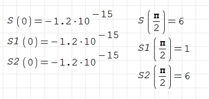

There is a behavior that I realized while playing with sMath. When you place the cursor in front of the operator, sMath underlined the operator and all of its operants:
![2019-05-10 07_45_56-SMath Studio - [ISERROR QUESTION MARK_B.sm].png](/en-US/files/Download/GhRWpA/2019-05-10-07_45_56-SMath-Studio---[ISERROR-QUESTION-MARK_B.sm].png)
![2019-05-10 07_46_25-SMath Studio - [ISERROR QUESTION MARK_B.sm].png](/en-US/files/Download/8HuyWT/2019-05-10-07_46_25-SMath-Studio---[ISERROR-QUESTION-MARK_B.sm].png)
If I were attentive enough, I could of found what was happening a lot faster...
When you are inside a operator, sMath underline only the inside operator:
![2019-05-10 07_47_22-SMath Studio - [ISERROR QUESTION MARK_B.sm].png](/en-US/files/Download/6cAPoX/2019-05-10-07_47_22-SMath-Studio---[ISERROR-QUESTION-MARK_B.sm].png)
For the sake of intuitivity, I guest adding the "Excel parenthesis" behavior would of enlightened me
Guy

#7 Posted: 5/10/2019 10:31:12 AM
WroteIn sMath, one solution could be to flash a set of parenthesis
Oh ! NEVER-ever that, Smath is as it must be, you will soon get used.
No possible mistake, as you open ( it closes as well, then plug-in stuff.
Mathematica 4.0 opens ( and shows were to close in color.
Never used Excel for last 20 years.
Mathcad only opens ( then close anywhere even in the blue.
OriginLab like Mathcad, open ( close were desired
The document I returned: does it work ?
Don't hesitate for any question. Often, doctoring is few clicks.
