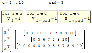

SMath Forum SMath Studio Questions How works for loop ? 1 Pages (3 items) How works for loop ? - for loop generates extra zeros - Messages Go to last post #1 Posted: 4/19/2019 10:09:59 AM inazuma 0 likes in 1 posts. Group: User Hello,I'm a newbie in SMath, so maybe it's just a bad usage.Why the following for loop:I:=[5..10]for i € I xi := igenerate this result:x=[0 0 0 0 5 6 7 8 9 10]Thank you for your answer ! #2 Posted: 4/19/2019 10:51:58 AM Martin_B 21 likes in 84 posts. Group: User You are assigning the values 5 to 10 to the 5th, 6th ...up to 10th element of the vector x.The first 4 elements are filled with zeros. 1 users liked this postDavide Carpi 4/20/2019 5:37:00 AM #3 Posted: 4/19/2019 8:51:22 PM Jean Giraud 983 likes in 6866 posts. Group: User WroteWhy the following for loop: 1 users liked this postDavide Carpi 4/20/2019 5:37:00 AM 1 Pages (3 items) New Posts No New Posts
