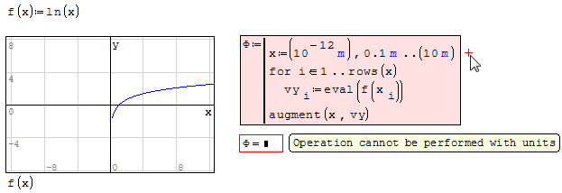

Honestly, I'm lost in there. The project is so messy, it lacks sound preparation.
Your Rint 0 generates "division by zero" easy to imagine that Rint may not be
exactly 0 ... 10^-12 is very close to 0.

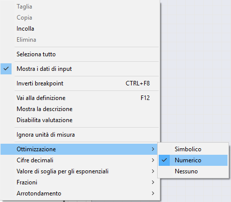

On the other hand, the while loop must be "Numeric" NOT Optimiz
Also, part of the while loop does not like Units.
My Smath version 6179
Would be wise to work unitless.
Will be back ... Jean

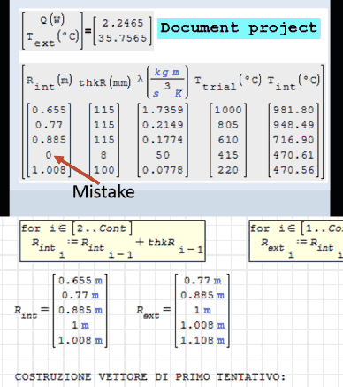

Your Rint 0 generates "division by zero" easy to imagine that Rint may not be exactly 0 ... 10^-12 is very close to 0.
I see that Rint=0 his coming from a modification in the calculation of the internal radius of the first layer of lining; it was Rint[1 in my file, resulting in a non-zero radius.
I see Rint[2 in yours, so first element of the vector is set to zero while second element stores the radius.

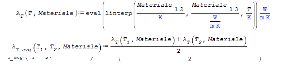

I didn't really get a chance to go through the math at all, but I did optimize run time of the current implementation. I used the eval() function in the lamda_t function definition. Took evaluation from 20 seconds to 0.25 seconds on my machine.
PROVA CONDUZIONE TERMICA_bkp_alyles.sm (65.88 KiB) downloaded 769 time(s).

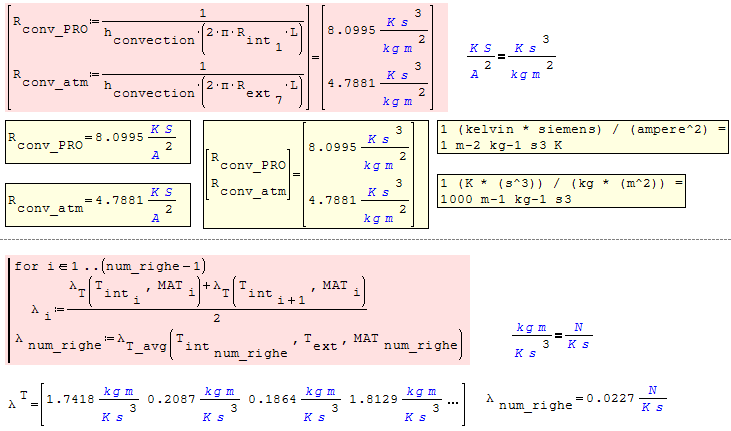

Is there a way to understand during debugging if and why the units are creating the problem?
I know Jean has an aversion to using the built-in unit system within SMath, but I use it frequently without issue. I've not noticed a decrease in performance when using units vs. defining programs to be unitless. I personally think the use of units in calculation is extremely useful in quickly validating general arithmetic and results. Working with units can sometimes be a pain in the sense that when generating equations/programs you may often run into issues where units don't match (and calculations cannot complete) or end results don't make sense. Again, I find this useful in understanding all the different components of the equations/programs I generate.
#7 Posted: 6/19/2018 8:45:12 PM
Work 1rst modular like in the attached.
Most confusing are different but equivalent maths that output different unit system.
What other simple maths will output another/same unit system or "Units don't match".
PROVA CONDUZIONE TERMICA_bkp [0].sm (94.05 KiB) downloaded 633 time(s).

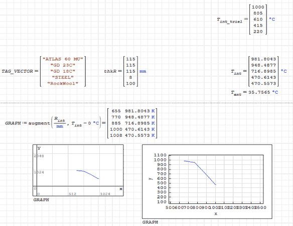

A small modification
PROVA CONDUZIONE TERMICA_bkp_CBG.sm (224.77 KiB) downloaded 795 time(s).
Carlos

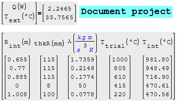

#9 Posted: 6/20/2018 10:39:03 AM
Thanks Carlos for doctoring this project.
1. Refreshed a bit
2. Few more things at the end.
3. "L" is confusing as not explained ... considered "unary"
4. Two pests [in green] wrt to units.
5. The last 4 "clear" removed from program [avoid red]
Wait and see for Originator to comment/complement
PROVA CONDUZIONE TERMICA_bkp_CBG [Jean].sm (344.38 KiB) downloaded 636 time(s).

I think there is an error in the internal radios.
Carlos

I will review all the contributions one by one, I just had the chance right now to go through the posts now quickly..
The use of eval() is somehow new to me, I will look at it's implications, since I understand that it has improved a lot the execution time.
Yesterday morning I spent some minutes again testing my file and became suspicious at how I implemented lambda.
It looks like I was accessing to that database matrix a lot of time.
Now I see that a great improvement has come from this eval() function...

#14 Posted: 6/20/2018 4:50:05 PM
Hello Jean
Thanks Carlos: my mistake from copy/paste, delete 'm'
Forgot the unit system bug that does not output 0m, 1m.
That bug was reported long time ago, may have corrected in 6671.
Added: Hermite sub-space fillet.
Project PROVA CONDUZIONE TERMICA_bkp_CBG [Jean].sm (390.83 KiB) downloaded 628 time(s).

Ok, I took my time to study all the files you posted and read all the replies again and again.
I'm happy to see that the "while" was messy, not commented properly, etc etc... but it could work (with some help)!
And also the lambda function and the way I defined the database...
First of all, going to your contributions, now I see what Jean meant with one of the first replies:
I needed to right click and set the while to Numerical optimization?
Setting my original file this way, makes the loop work quickly (shame on me, I wasn't even aware of such setting...)
Also Alyses hint has helped me to understand that the symbolic evaluation was the problem, and that some different setting should be implemented.
... I did optimize run time of the current implementation. I used the eval() function in the lamda_t function definition...
Iinfact, the following files by other users did not use the eval() function, so I was kind of lost, until I found that right click setting...
So, in the end, if my understanding is correct, eval() and right-click numeric optimization setting are equivalent, isn't it?
Now, going to Carlos contribution, thanks, I see that you found the way to make all the "if" and "while" loops scalable, meaning that I can add / subtract layers of lining.
The length of arrays, the number of loops will now automatically adapt... that was one of my goals, except that I got stuck in the execution time problem, so stayed simple with seven fixed layers of materials. Thank you.

Ps: by the way, totally on the same page here, but I see Jean's point in running unitless with his example he provided too...

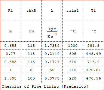

#16 Posted: 6/20/2018 10:03:18 PM
ean, what command are you using to generate this kind of matrix? What is the sintax, I mean,to define Q(w) or T.ext (°c) and obtain results without Units? Looks like it is a Custom Function again.
That, mon ami, is too simple doing ... like this:
1. from the matrix palette, insert a 2 rows by 5 cols
2. in 2nd row, paste results from above results,
backspace on units Rint ... bacspace on all 'm'
3. in 1rst row, type trial(Alt+248C) => trial(°C)
4. λ(,) ... kg*m/s^3*K from result above
This type of matrix project collection is natural, fast
and fully accessible by more maths from other demands.

... Data Table added. No problem to construct and display.
Couldn't reduce the height of the two first rows ... Ah !
Project PROVA CONDUZIONE TERMICA_bkp_CBG [Jean].sm (402.64 KiB) downloaded 670 time(s).
