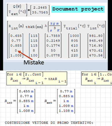

Your Rint 0 generates "division by zero" easy to imagine that Rint may not be exactly 0 ... 10^-12 is very close to 0.
I see that Rint=0 his coming from a modification in the calculation of the internal radius of the first layer of lining; it was Rint[1 in my file, resulting in a non-zero radius.
I see Rint[2 in yours, so first element of the vector is set to zero while second element stores the radius.

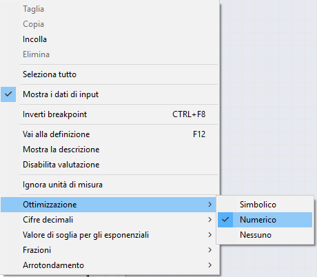

On the other hand, the while loop must be "Numeric" NOT Optimiz
Also, part of the while loop does not like Units.

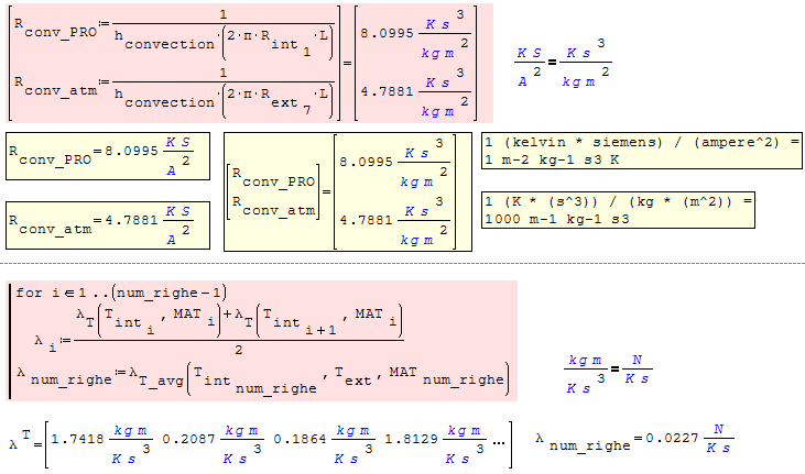

Work 1rst modular like in the attached.
Most confusing are different but equivalent maths that output different unit system.
What other simple maths will output another/same unit system or "Units don't match".

3. "L" is confusing as not explained ... considered "unary"
4. Two pests [in green] wrt to units.

Hello Jean
I think there is an error in the internal radios.
Carlos

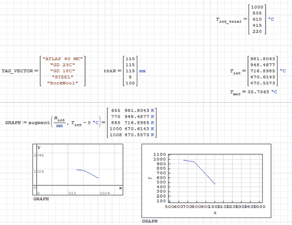

Hi everybody, thanks for all the efforts and support.
I will review all the contributions one by one, I just had the chance right now to go through the posts now quickly..

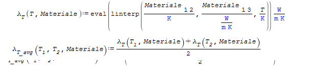

The use of eval() is somehow new to me, I will look at it's implications, since I understand that it has improved a lot the execution time.
Yesterday morning I spent some minutes again testing my file and became suspicious at how I implemented lambda.
It looks like I was accessing to that database matrix a lot of time.
Now I see that a great improvement has come from this eval() function...
Will go through the details and keep you posted.

Thanks Carlos: my mistake from copy/paste, delete 'm'
Forgot the unit system bug that does not output 0m, 1m.
I needed to right click and set the while to Numerical optimization?
Setting my original file this way, makes the loop work quickly (shame on me, I wasn't even aware of such setting...)
Also Alyses hint has helped me to understand that the symbolic evaluation was the problem, and that some different setting should be implemented.
... I did optimize run time of the current implementation. I used the eval() function in the lamda_t function definition...
Iinfact, the following files by other users did not use the eval() function, so I was kind of lost, until I found that right click setting...
So, in the end, if my understanding is correct, eval() and right-click numeric optimization setting are equivalent, isn't it?

#16 Опубликовано: 20.06.2018 22:03:18

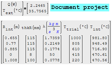

ean, what command are you using to generate this kind of matrix? What is the sintax, I mean,to define Q(w) or T.ext (°c) and obtain results without Units? Looks like it is a Custom Function again.
That, mon ami, is too simple doing ... like this:
1. from the matrix palette, insert a 2 rows by 5 cols
2. in 2nd row, paste results from above results,
backspace on units Rint ... bacspace on all 'm'
3. in 1rst row, type trial(Alt+248C) => trial(°C)
4. λ(,) ... kg*m/s^3*K from result above
This type of matrix project collection is natural, fast
and fully accessible by more maths from other demands.

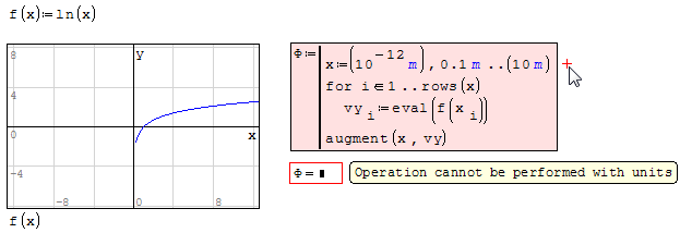

About your other question: optimiz mode, eval there is no clear 1/1 answer.
In some advanced maths, the RHS , i.e: the function must be set in eval(,) mode.
Observe: Genfit Rational Type J_6
1. Minimize(XY,f,φ,β) .... some eval(,) within overall numeric

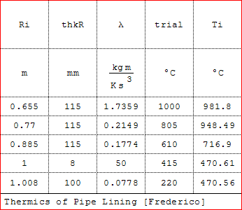

#18 Опубликовано: 21.06.2018 13:18:42
... Data Table added. No problem to construct and display.
Couldn't reduce the height of the two first rows ... Ah !
Project PROVA CONDUZIONE TERMICA_bkp_CBG [Jean].sm (402,64 КиБ) скачан 967 раз(а).
