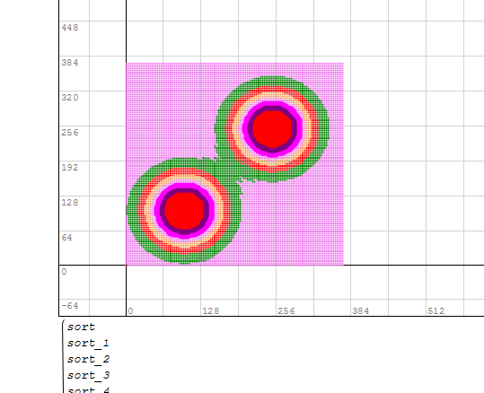

Hello all. This is my case. It runs dramatically low. Can anyone give a hint for increasing speed? Or such a situation is normlal. Thanks.Postroenie polja riska.sm (148.07 KiB) downloaded 1108 time(s).

Select all regions and put Optimization->Numeric

Great! Fantastic! I was nearly diappointed, but it is really TOOL.

Much different stuff ... you can shift another set,
as well as plot in a random filled square.
Too long to resume in my laptop.
Circle Magic Disk.sm (27.28 KiB) downloaded 1149 time(s).

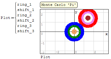

1. You can have as many rings as desired, sizes as well.
2. It may be profitable to transit/spool to file.
3. You may have in any Web colors from otherwise construction ?
4. Rectangle may be added ?
Circle Monte Carlo.sm (24.04 KiB) downloaded 1081 time(s).

2 confirmations:
1. Spool to file YES for recovering from other document.
2. Web colors YES from code ... somewhat greedy !
Circle Monte Carlo.sm (32.22 KiB) downloaded 1104 time(s).

... a much faster version.
Circle Monte Carlo.sm (33.97 KiB) downloaded 1099 time(s).
