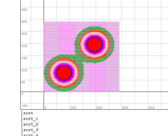

#4 Posted: 2/1/2020 5:33:30 PM
983 likes in 6866 posts.
Much different stuff ... you can shift another set,
as well as plot in a random filled square.
Too long to resume in my laptop.
Circle Magic Disk.sm (27 KiB) downloaded 89 time(s).

#16 Posted: 2/28/2020 10:21:58 AM
As interpreted ... ?
1. You can have as many rings as desired, sizes as well.
2. It may be profitable to transit/spool to file.
3. You may have in any Web colors from otherwise construction ?
4. Rectangle may be added ?
Circle Monte Carlo.sm (24 KiB) downloaded 74 time(s).

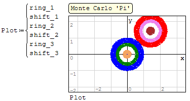

#17 Posted: 2/28/2020 11:40:50 AM
2 confirmations:
1. Spool to file YES for recovering from other document.
2. Web colors YES from code ... somewhat greedy !
Circle Monte Carlo.sm (32 KiB) downloaded 85 time(s).
#18 Posted: 3/2/2020 5:43:34 PM
... a much faster version.
Circle Monte Carlo.sm (33 KiB) downloaded 82 time(s).
