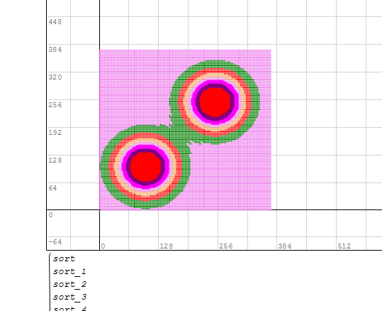

Much different stuff ... you can shift another set,
as well as plot in a random filled square.
Too long to resume in my laptop.

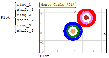

Circle Magic Disk.sm (27 КиБ) скачан 63 раз(а).

... not clear what the project should produce ?
Presumably => concentric circles for RGB image
maybe for exporting data set ?
#16 Опубликовано: 28.02.2020 10:21:58
As interpreted ... ?
1. You can have as many rings as desired, sizes as well.
2. It may be profitable to transit/spool to file.
3. You may have in any Web colors from otherwise construction ?
4. Rectangle may be added ?
Circle Monte Carlo.sm (24 КиБ) скачан 49 раз(а).

Circle Monte Carlo.sm (32 КиБ) скачан 60 раз(а).

Circle Monte Carlo.sm (33 КиБ) скачан 57 раз(а).
