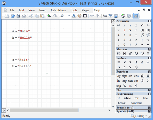

Hello Barmin
The function you are looking for was previously available in previous versions of smath, such as version 5737.
I do not know why they disabled it. Here I put an example in that version.
Test_string_5737.zip (359.64 KiB) downloaded 401 time(s).
Carlos

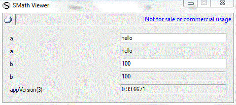

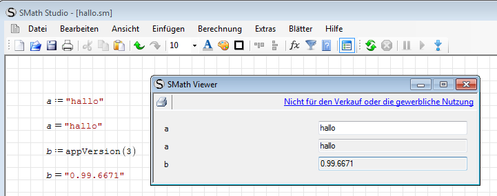

Can't reproduce
hallo.sm (2.75 KiB) downloaded 1109 time(s).
hallo.zip (482.23 KiB) downloaded 386 time(s).
#8 Posted: 7/2/2018 11:11:51 AM
Arie
Arie
94 likes in 285 posts.
Martin,
Once the Viewer is running try to change the value of Hallo and notice if it doesn't update in the second box.

#10 Posted: 7/3/2018 4:58:49 AM
For me it works. Yet I have to press enter to forward the changes in the input box.

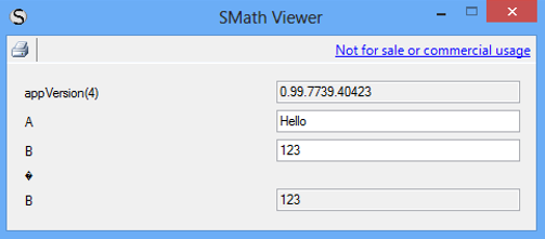

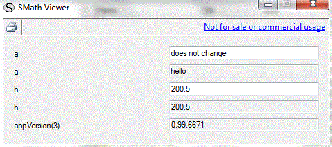

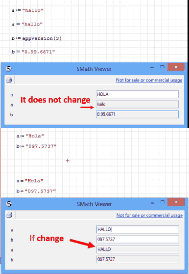

#11 Posted: 7/3/2018 6:14:27 AM
For me it will change the numerical variable but not the string one (with return pressing, of course).
before
after
#12 Posted: 3/5/2021 3:38:37 PM

You are right, the text change in the variables still does not work.

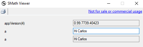

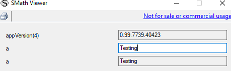

#18 Posted: 3/12/2021 10:08:51 PM
26 likes in 155 posts.
Seems to be working just fine for me.
99.7739.40423_Test_exe.zip (571.28 KiB) downloaded 361 time(s).
Good Luck!
