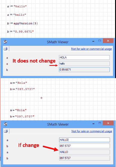

I have a question if it's possible to display the string part of a matrix in *.exe file created from a Smath file?
Screenshot of issue
Tried the var2string function, but after changing the string value via exe file, it reads function argument name (a) instead of it's value.
Is there some kind of workaround for this issue?

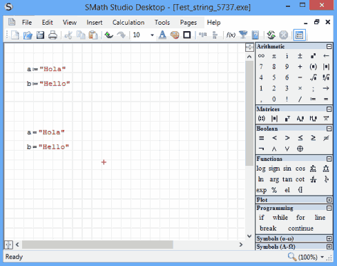

Hello Barmin
The function you are looking for was previously available in previous versions of smath, such as version 5737.
I do not know why they disabled it. Here I put an example in that version.
Test_string_5737.zip (359,64 КиБ) скачан 350 раз(а).

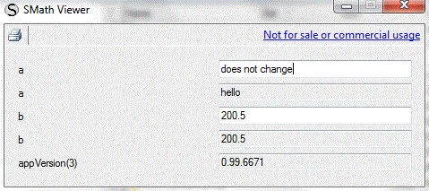

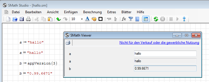

Can't reproduce
hallo.sm (2,75 КиБ) скачан 1008 раз(а).
hallo.zip (482,23 КиБ) скачан 329 раз(а).
#8 Опубликовано: 02.07.2018 11:11:51
Arie
Arie
Martin,
Once the Viewer is running try to change the value of Hallo and notice if it doesn't update in the second box.

For me it works. Yet I have to press enter to forward the changes in the input box.

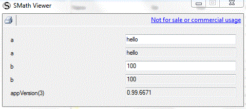

#11 Опубликовано: 03.07.2018 06:14:27
For me it will change the numerical variable but not the string one (with return pressing, of course).
before
after

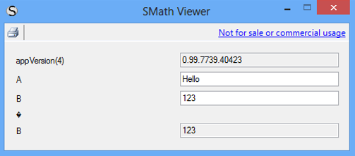

You are right, the text change in the variables still does not work.
Carlos
#15 Опубликовано: 11.03.2021 23:00:50
26 сообщений из 155 понравились пользователям.
Please take a look at this topic. You will need the latest nightly build to have functionality.

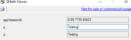

I did a test with the latest version of Smath Studio and the Viewer and it does not work
Carlos
#17 Опубликовано: 12.03.2021 15:03:32
Carlos
Hi. Carlos it's right. I guess that there are an issue with the automatic update within the nightly build which seems to be now appVersion(4)="0.99.7739.40423"@# but previously I have appVersion(4)="0.99.7739.41xxx "@# or something like that.

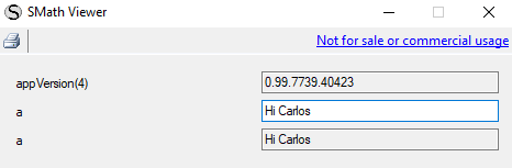

Seems to be working just fine for me.
99.7739.40423_Test_exe.zip (571,28 КиБ) скачан 305 раз(а).
Good Luck!
#19 Опубликовано: 12.03.2021 22:12:22
I'm using 64bit Win10 Enterprise by the way. Maybe it matters?
Alvaro 12.03.2021 23:30:00
#20 Опубликовано: 12.03.2021 23:29:48
Me too, but 32 bits. I'm reinstall SMath and now works fine.
