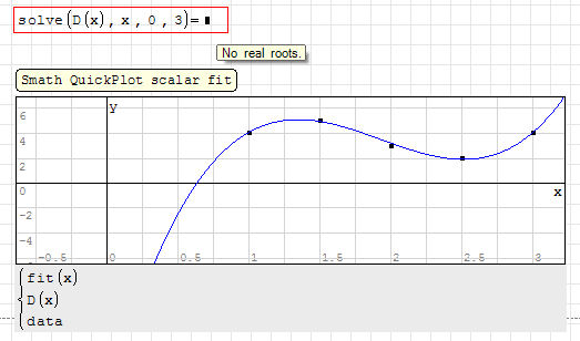

#3 Posted: 3/12/2016 10:52:53 AM
Non linear solver of some kind, poorly documented.
The Mathcad Given/Find would solve with an objective
function [my newbie interpretation]. The "M"
in the attached would solve "Pseudoinverse", posted
few weeks ago in the forum.
Polynomial fit_D[x].sm (18.53 KiB) downloaded 964 time(s).

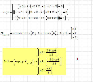

Jean, I am not quite sure how to use your solver in my case... From what I understood you were attempting to solve the under/overdeterminate system of equations (this is what I have); I am somewhat confused to what is the solution?

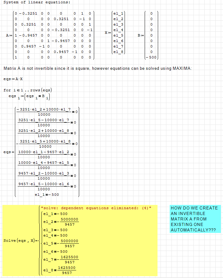

Anyway, from educations perspective, is the a way to solve the following without using Maxima:
solveMaxima.sm (16.48 KiB) downloaded 1133 time(s).

Jean, would you happen to know how to find and remove reduntant rows from a coefficient matrix A, that happens to have more rows than columns:
A x X = B
X = A^-1 x B
SolveEquationMaxima.sm (14.67 KiB) downloaded 1103 time(s).
A x X = B
X = A^-1 x B
This is solved using DotNumerics plugin.
Thanks, Uni!
SolveEquationDotNumerics.sm (9.73 KiB) downloaded 1119 time(s).

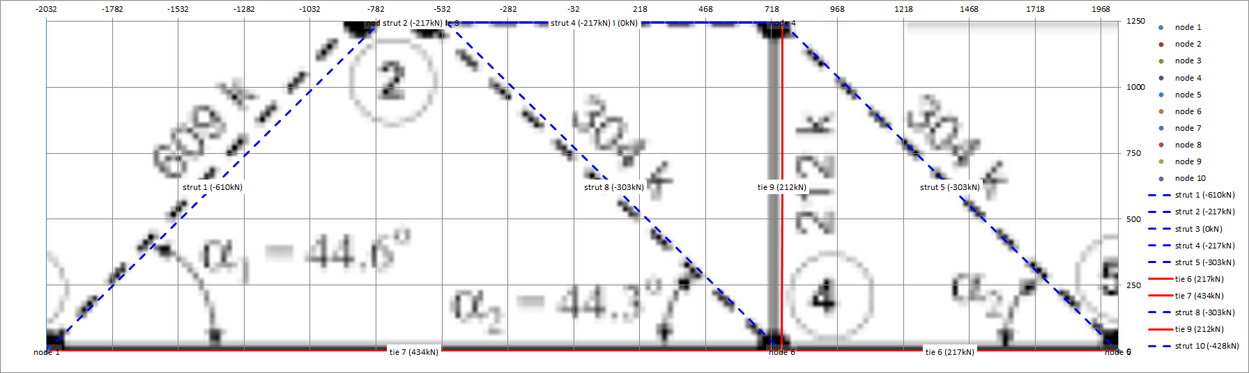

And a little teaser of what I am working on... Everything you see was created by an EXCEL macro (from graphical representation perspective), solved in SMath and presented in EXCEL.
Process of model creation / presentation / solution is fully automated.

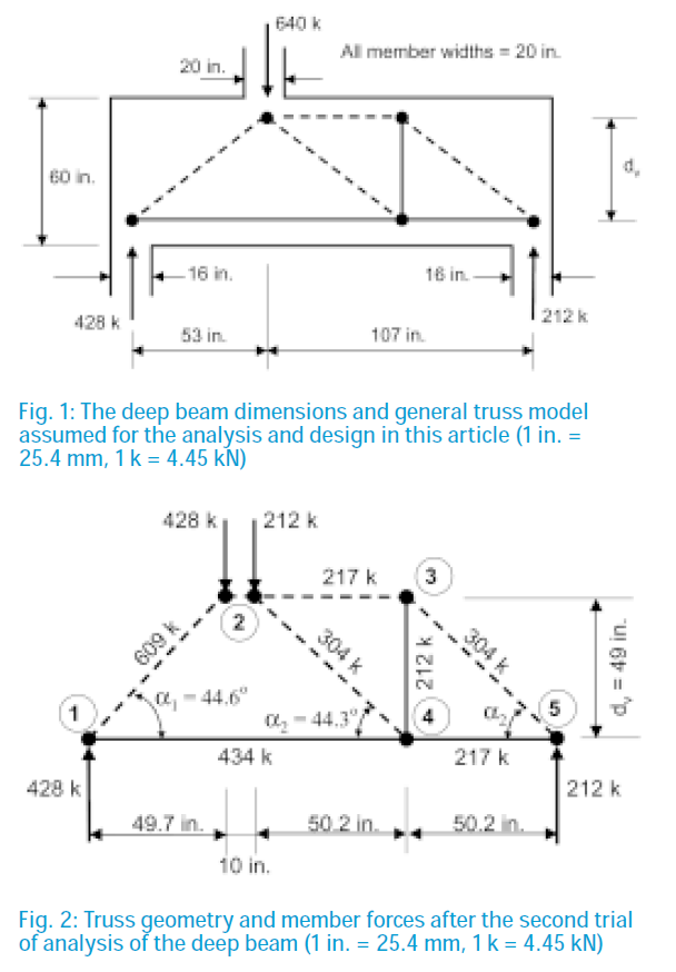

I googled around the subject and I noticed an enormous quantity of documents, many dedicated to the experimental side.
It seems that the treatment is often very specific to any concrete problem.
For instance in the appended document ci2505wight.pdf (155.21 KiB) downloaded 11144 time(s).they go to modify the physical height of the beam in order to satisfy the model, what's not usual in engineering.
However, the subject is for specialists and therefor, I decline my intrusions; I'm a specialist but not in this item.
It's strange for me to understand how they obtained that the reaction on the left support is 428k while a simple calculation gives 640*107/(107+53)= 361k and the beam is nothing that a simply supported beam. Does the beam know this forcing "joke" ?
As I know the apparently forum composition, it is not here the right place to "negotiate" such a fine item

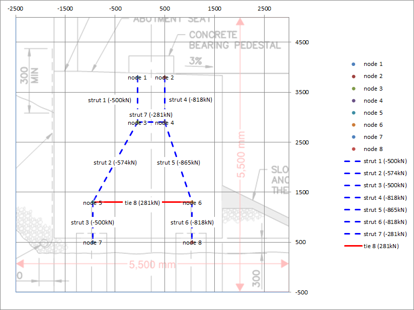

And this little guy took me about 20 minutes to setup.. Mostly defining coordinates and stuff. If the drawing was to scale I could have just located the nodes of my strut & tie graphically.
Small typo:
640*107/(107+53)= 428
