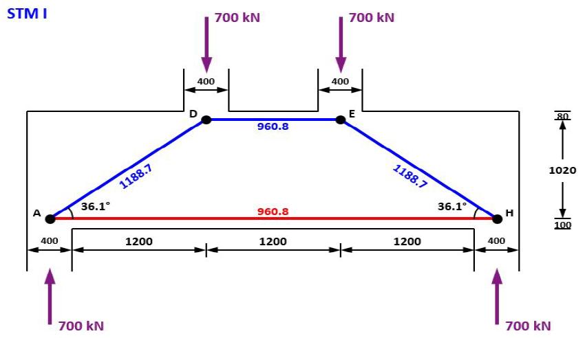

Anyway, from educations perspective, is the a way to solve the following without using Maxima:
solveMaxima.sm (16,48 КиБ) скачан 1133 раз(а).

Alex,
As now things get more sense. Always an example or a sketch tell more than a long speech
Not importing on your mathematics tool you are in front of a mechanism case (physically speaking) that means that you have 3 equations and 4 unknowns.
Such a system has a simply infinity of solutions.
As I already said, you need a complementary condition to determinate the system from mathematical viewpoint.
One solution is to take one of unknowns as parameter and to determine it with an optimization technique, for instance in respect with the energy.

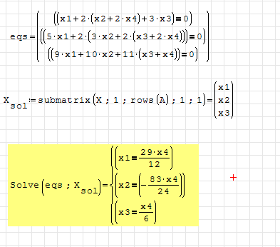

Ioan, one of the reasons why I am not going the FEA way for this task, is because in my design office there is a strong opinion against it (not the best tool for the task? influence of late James MacGregor? - I do not know) Those zero force members almost always end up carrying some load.. Anyway - I must do it the sum(F.x) = 0 & sum (F.y) = 0 way.
So if you, or anyone else know how to solve equations from post 11 the SMath way (3 equations, 4 unknowns, symbolic solution of 3 unknowns in terms of the 4th unknown) I would much appreciate it. So far I tried roots() and maxima's Solve(). Solve() works.

So long as your system has more unknown then equations, the problem is with a infinity of solutions.
Only if you add some conditions, you can hope for a solution; if not no miracle (marabou) hope...
But of course, wait for some others lights.
Why not, maybe we ignore some sides...
You are correct - there are some other sides to it.
One of them is that when there are 3 unknowns (3 struts whose force is unknown, one strut whose force is known) and two equations of equilibrium at the node, you can guess the ratio between the unknowns (say strut 1 has same load as strut 2 while strut 3 is different, and strut 4 is known). You can base your guess on stiffness, however you do not always know the stiffness before proportioning struts, ties, and nodal zones. You can base your guess on strut angle. You can even do a wild guess, and given the nature of strut and tie (lower bound solution) the structure will behave AT LEAST as good as your guess was, and most likely better (if your guess was incorrect the structure will find a better load path).
So you always have same # of unknowns as # of equations. Except that some of the equations come from engineering judgement (difficult to program ), while others are from routine equilibrium.
And I probably can setup my solution in a way that does not require solving 3 equations with four unknowns, but heck, for educational purposes, can SMath do it (and how)? Maxima can.

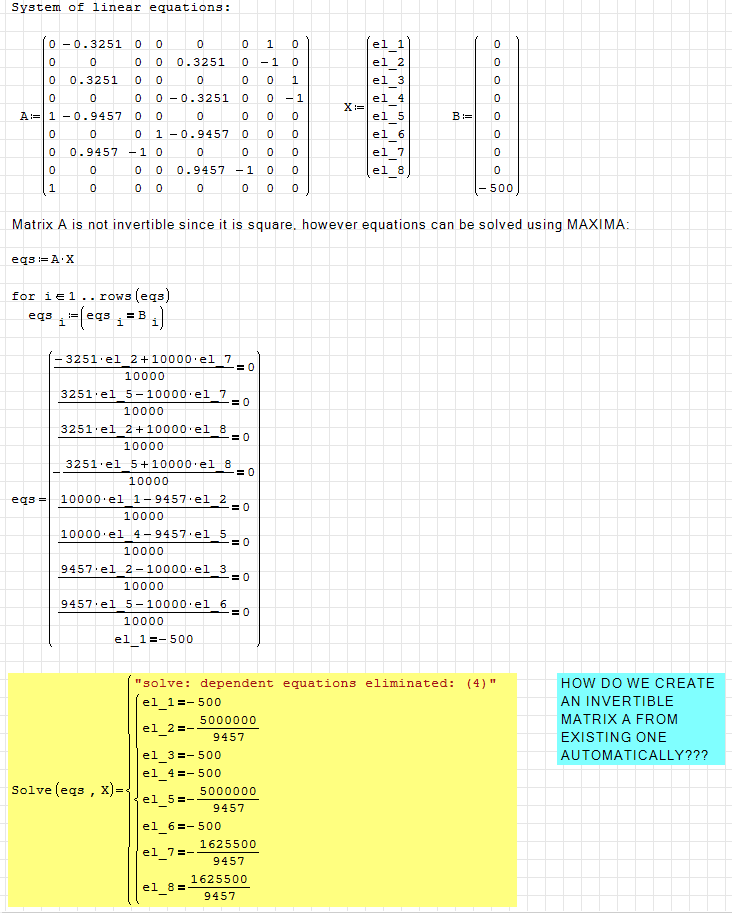

Jean, would you happen to know how to find and remove reduntant rows from a coefficient matrix A, that happens to have more rows than columns:
A x X = B
X = A^-1 x B
SolveEquationMaxima.sm (14,67 КиБ) скачан 1103 раз(а).

like one author
said that a 10000 x 10000 matrix reduced to as
low as 100 x 100.
A x X = B
X = A^-1 x B
This is solved using DotNumerics plugin.
Thanks, Uni!
SolveEquationDotNumerics.sm (9,73 КиБ) скачан 1119 раз(а).

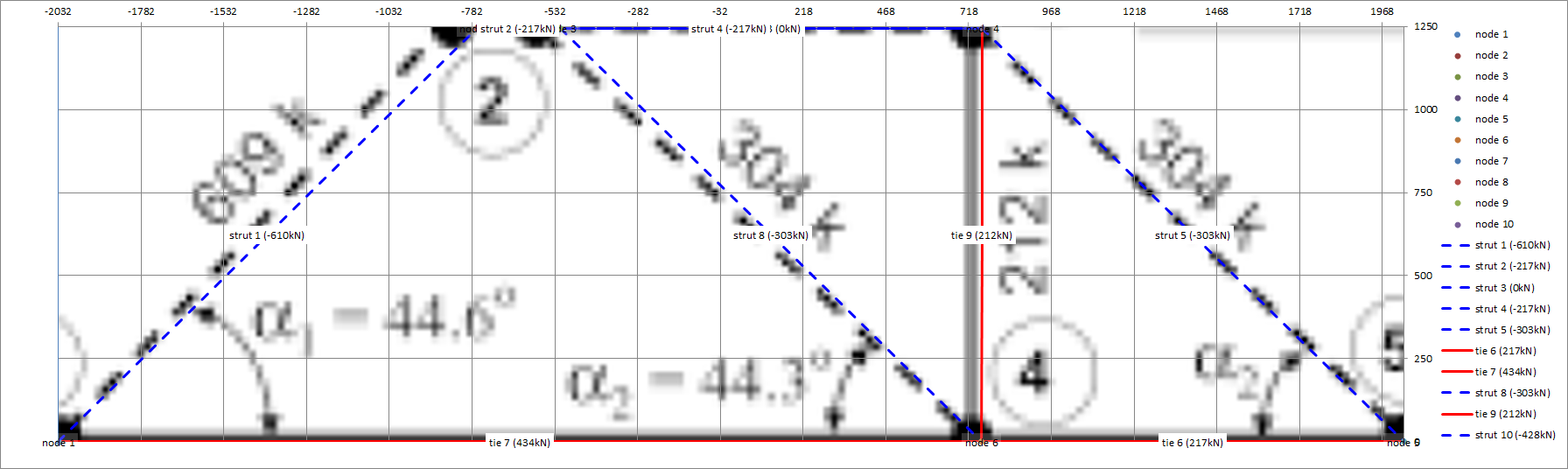

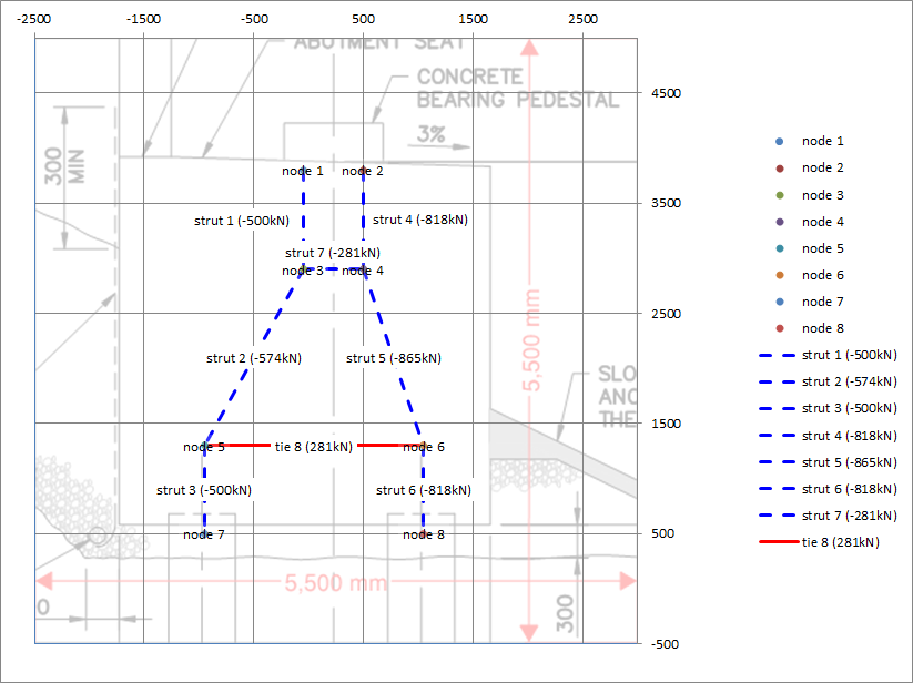

And a little teaser of what I am working on... Everything you see was created by an EXCEL macro (from graphical representation perspective), solved in SMath and presented in EXCEL.
Process of model creation / presentation / solution is fully automated.
By the way, Ioan, SMath solution of this strut & tie worked from the very first attempt - felt like a miracle

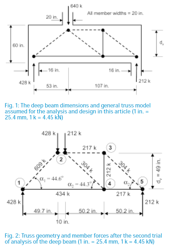

I googled around the subject and I noticed an enormous quantity of documents, many dedicated to the experimental side.
It seems that the treatment is often very specific to any concrete problem.
For instance in the appended document ci2505wight.pdf (155,21 КиБ) скачан 11144 раз(а).they go to modify the physical height of the beam in order to satisfy the model, what's not usual in engineering.
However, the subject is for specialists and therefor, I decline my intrusions; I'm a specialist but not in this item.
It's strange for me to understand how they obtained that the reaction on the left support is 428k while a simple calculation gives 640*107/(107+53)= 361k and the beam is nothing that a simply supported beam. Does the beam know this forcing "joke" ?

And this little guy took me about 20 minutes to setup.. Mostly defining coordinates and stuff. If the drawing was to scale I could have just located the nodes of my strut & tie graphically.

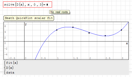

"on error" for branching the "while" loop. I'm actually working
on a picewise continuous function [not solvable]. Smath comes
close but never exact enough ... like Smath laughing hihihi !

... just solved the "unsolvable". Ah ! the silent bugger.
What is it ? the piecewise continuous function is very
granular. So, "init" has to be pushed manually, surprise.
Small typo:
640*107/(107+53)= 428

Hi All,
Did not expect this topic to spur such a conversation but hey, the more opinions the merrier!
Very impressive and clean truss model, Ioan, looks great.
Side thought - I am not really going "outside from the road" with my solution... simple force equilibrium at nodes. We can chat more.
Alex
